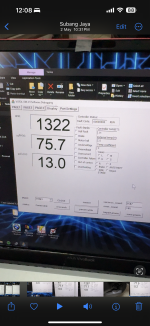

Hello to all, a im back, bought new em80gts votol witn CaN interface and found weird think like that in soft dont working voltage monitoring and etc..... can't understand Why.... Reading and flashing controller is ok.... What IAM doing wrong?
FIX ))
CAN mode no ned to TAP )))) only speed 115200
