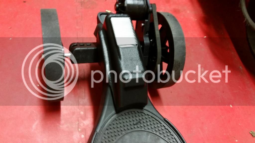

7s 6300mah removable battery cover done..in 3mm ABS so super strong ..you can stand on it easily.. just the ESC cover to cut to shape..
It snaps over the edge of the deck and then is held in place with velcro- very secure
Wooow, Clever "Keep It Simple" design - How does the components hold Inside ? I maybe misunderstood, will you make a specific cover for the ESC ? I guess you will route the cables under the deck?
the battery is a very tight snug fit- and yes i have a separate ESC cover that sits on the back tail.. yep wires go through the board then up through the hanging bracket hole at the tail..
yeah you would think so..ha ..i've run out of motors and batteries ..i've built that many boards!! lol... they should arrive this week..
once i've tested it and it runs ok..ill look at what ill do with the brackets...no problem

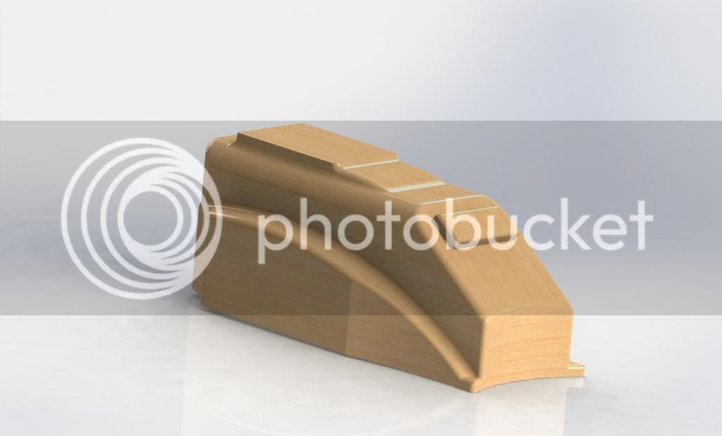

well i have been neglecting the Onda build due to other commitments but ive managed to get the ESC cover finished and a revised (smaller ) battery box for testing..im just waiting for the motor and battery to arrive...
Im pretty happy with the finish of the covers and they blend in nicely...

woohoow that's neat, amaizing how u managed to fit to the deck shape
i've machined a wooden mold on the NC mill formed it on my vac molder then trimmed the Abs back with a dremmel...fairly simple and i can make as many as i want now...:) same with the battery box..
the vac molder is an invaluable tool..it does help that i have use of a CNC miller also..:)
Tell me you have been using a 3D scanner to get the wooden mold shape so right, then I might really become jealous (just kidding :p )
..or was it some Cardboard Assisted Design ?
