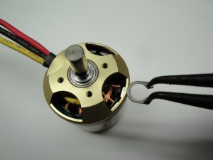

Does anybody know how to take apart the TACON motors? I need to take mine apart and clean it I got little metal parts in there?
Haven't found an easy way just yet. The magnets are pretty strong so you need to pull the motors out. The back end of the motor has set screws onto the motor shaft. Although, can't remember if I needed to take these out or not. Haven't done it in a while.
Anyone else know of an easy way to remove these?
I don't see any screws on the top just a c-clip. And I think there is 2 set screws on the broom but can't tell for sure.
What's te best way to take off the c-clips?
You can use C clip pliers which work the best.
Check this page here --- > http://www.jeromedemers.com/blog/2009/07/inside-the-motor/
Ok so I got it apart and cleaned it out with a aircompresser. But when I put it back togather it was still scratchy as if there is still shards in there.
How do I clean it out completely?
I managed to get more of the metal shards out but not with grease with a screwdriver. I think the tip of the screw driver was magnetic and it was able to pick up the metal shards. The motor doesn't have anymore grinding noise or feeling but I feel like the magnets in the motor around as strong anymore. ( I'm comparing it to the other TACON motor I have that was totally fine)
Could this be bec of the magnetic riped screw driver touching the magnets in the motor?
