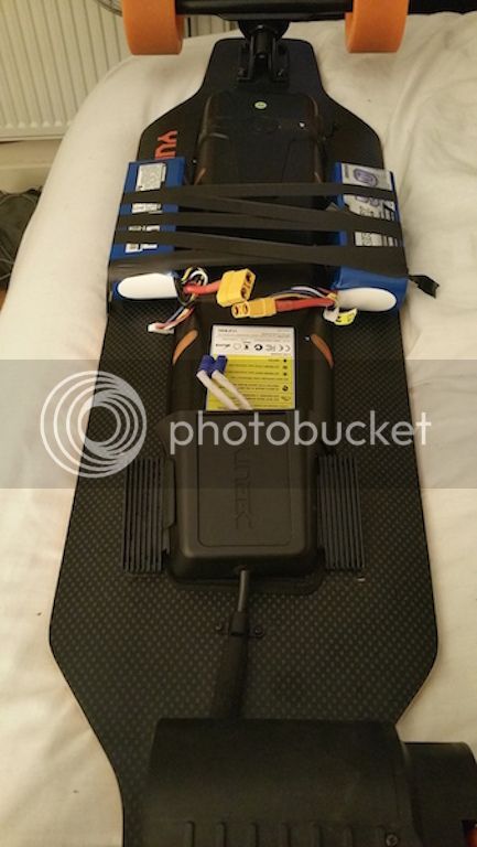

Thought i would share this with you all after reading this thread.....
as ghetto as it gets i know... but thought i would try my E-go on 10s today....
As we all know it's way underpowered and as far as i know, nobody actually knows what voltage the ESC will take without burning up...
as i find it that boring to ride now i don't even use it!!
so i thought i would be the guinea pig and give 10s a go
2 x 5s in series
max speed 19mph
hill climbing power is ridiculous compared to the standard pack
silly fast acceleration (i had to flick it over to ECO to tame it down a bit)
After 3 miles of stop starting to check temps, the ESC & Motor were no warmer than with the standard 7s battery
How long the ESC & Motor would last i don't know! (not very long i suppose)
I Don't think 10s is something i would run permanently but im definitely going to try an 8s setup and see what happens :roll:

Ive been out again tonight and done another 6 mile ride on 10s... ESC was lukewarm at best!
The motor was warm, but no more so than when using the original pack

The ESC seems to be performing ok on 10s... a motor upgrade would make it the perfect board for me
