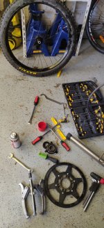

Time for a fresh rim on the back of my LMX. The stock Halo rim had a couple big dings from hitting square edges and rocks, and a broken spoke and some loose spokes so thought I'd lace up a the new rim I'd bought a couple months ago from one of my favourite online stores Bike24. I went with a Newmen E.G.35 which looks like a solid replacement for the Halo. The ERD is even quite similar, so if you choose to use the standard spokes a re-lace would be quite straight forward,. I went with a fresh set of SAPIM Strong spokes.
I recommend having a 3 jaw puller on hand to remove the sprag clutch assembly to get access to the right side spoke flange, but other than that it's fairly standard tools for a wheel lace job.
