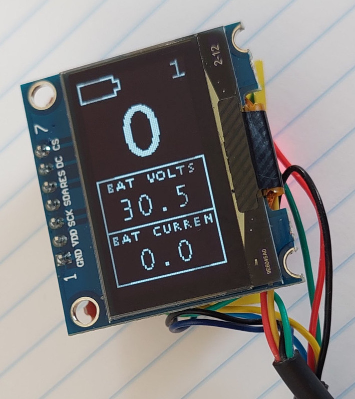

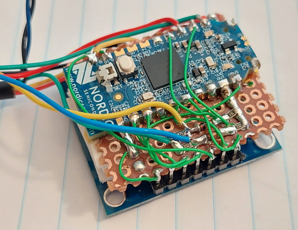

Current state of the display for Bafang M500/M600 motors:

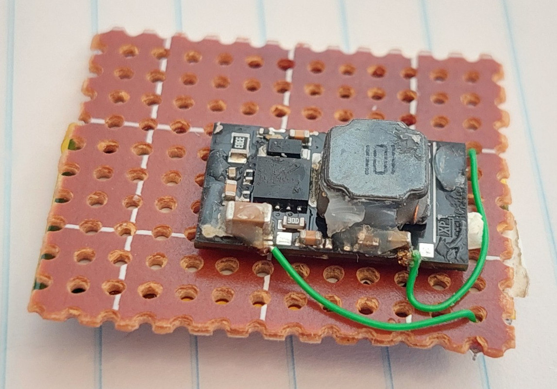

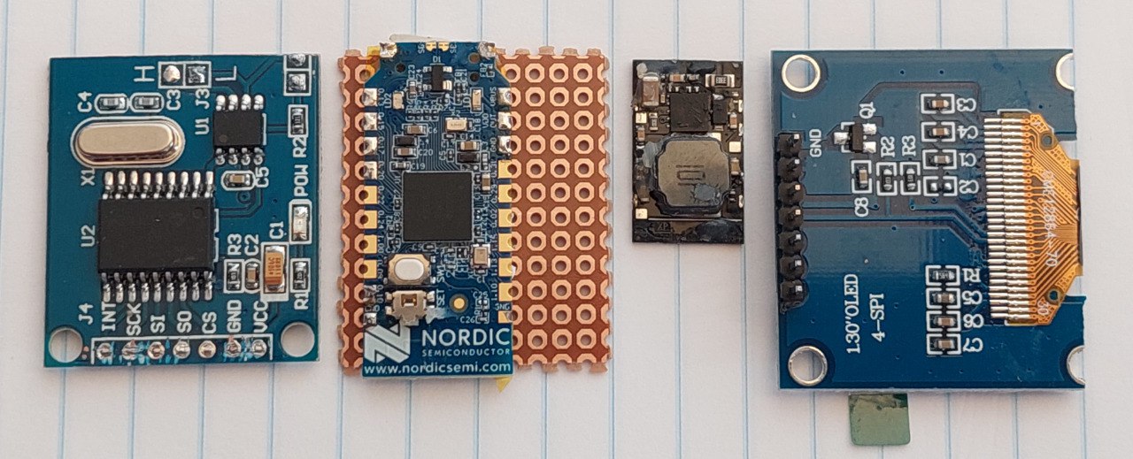

The build of the boards started as this:
Yes, some components has glue because I am reusing them from other displays I built for TSDZ2 Ebike motor:
All the wiring done except the ones for the CAN module. Here I can already see the display working as also see if I can turn ON/OFF:
On last step I add the CAN module:
Finally I connect to the Bafang motor and it should fully work:

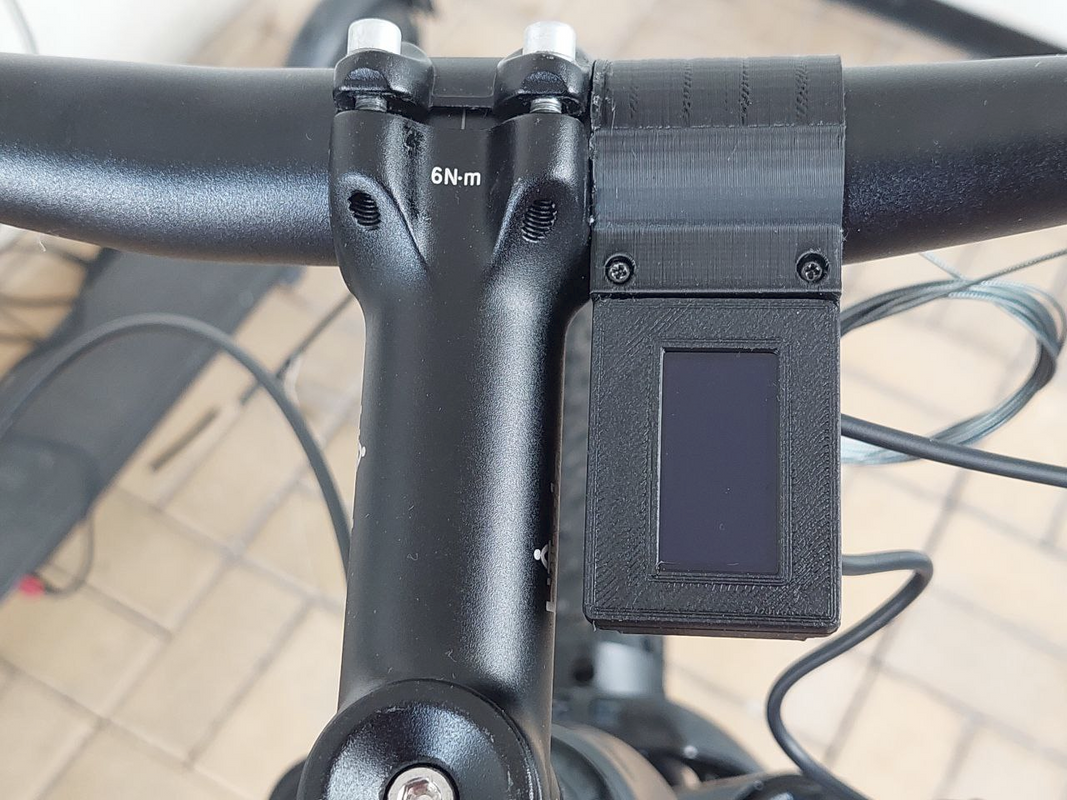

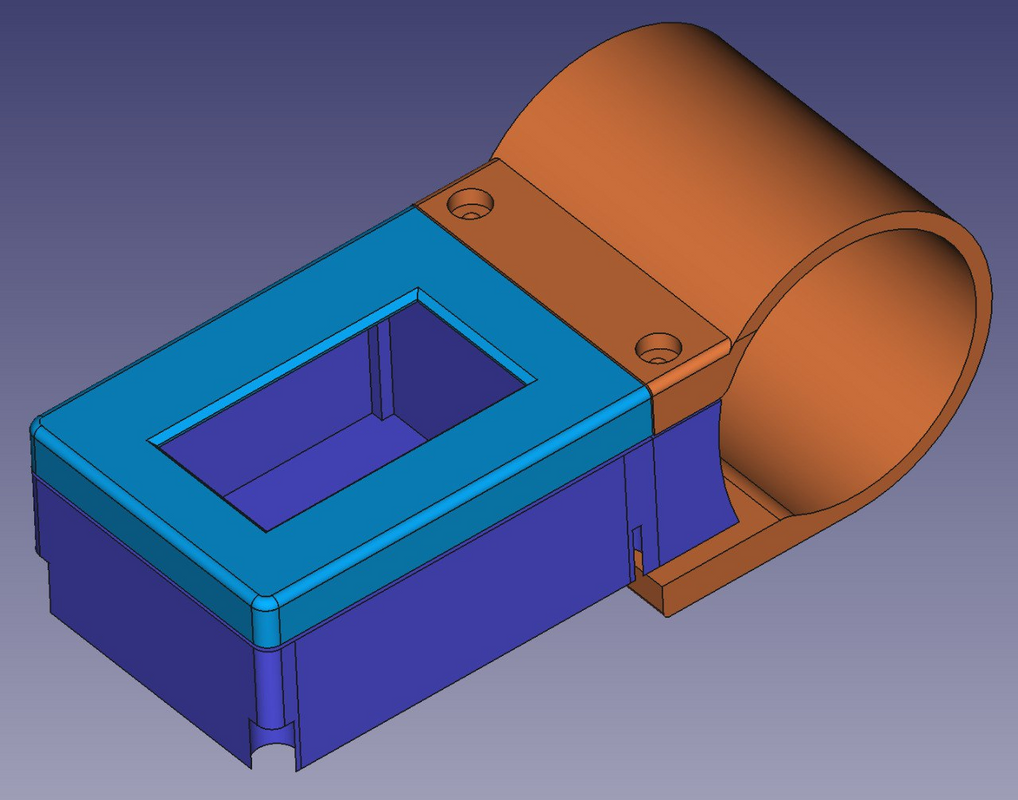

Yesterday I designed and 3D printed the enclosure final version:
The display works well, here is it installed on my handlebar:

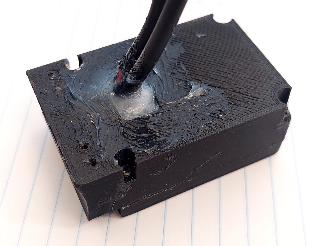

First, people like @casainho are awesome :D. I really enjoyed putting the display together. Although I wouldn't call it easy diy, if the easy is referring to how easy it is to build a display that is. With my fat fingers and thin wires it was a journey. Along the difficulties of soldering, at one stage I managed to solder the display upside-down :).
Anyway, my old display got ruined by rain so I really want this diy display to be super waterproof.
Any ideas?

Easy DIY because actually the electronics are assembled by machines and the components are so tiny like a grain of sand, so, it is easy comparing to actual technology that is only to be used by machines and not humans.
Super water prof? I would say do add some kind of glue all over 3D printed enclosure. Maybe even adding some glue layer on inside and then other on the outside.

Ok, thanks for the suggestion. I will try multiple things. I have ordered a transparent heat shrink tube, let's see how that plays out.

Here the way I use silicone:

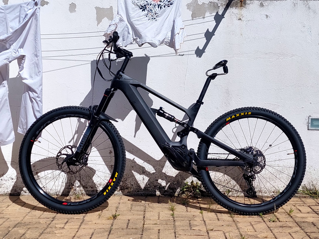

And my final EBike build, running perfectly with our OpenSource EasyDIY display (in fact, I end up to never use the original display):

The tape, it is really important to use it to avoid water entrance on the display:
