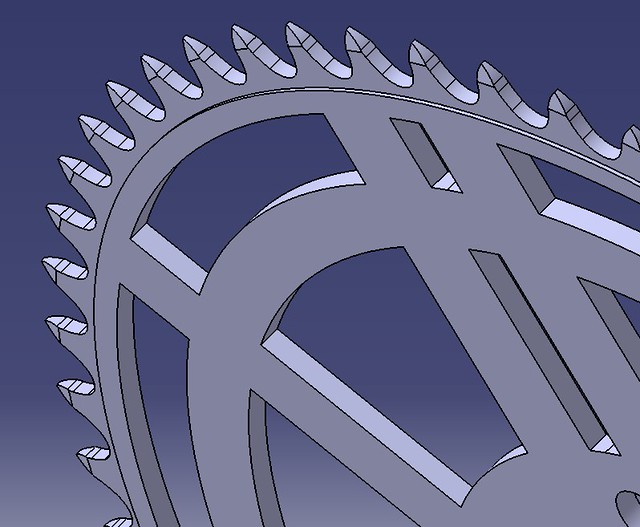

Please critique this 63T gear. I plugged and chugged some equations for the correct geometry for the teeth. I have not decided on a final spoke pattern but here's my latest design.. easy to mill... doesn't look too bad. strong?

Looks great, as long as the clearances are adequate to let the chain in and out without binding. That's definitely optimized for chain keeping rather than shifting. If you want to shift it, shorten the teeth like 25% (or shorten them just on the dead spots of the pedal stroke-- where the chainring will be passing the front derailleur when the pedals are and 12 and 6 o'clock).

Wasn't planning on doing any front shifting.. I no longer have a deraileur bolt nor am at low speeds long enough to justify more gears. Good to know though.
I've been trying to come up with a cool chainring spoke design and am not very creative with it as I would like to be. Does anyone have any suggestions or reference patterns?
