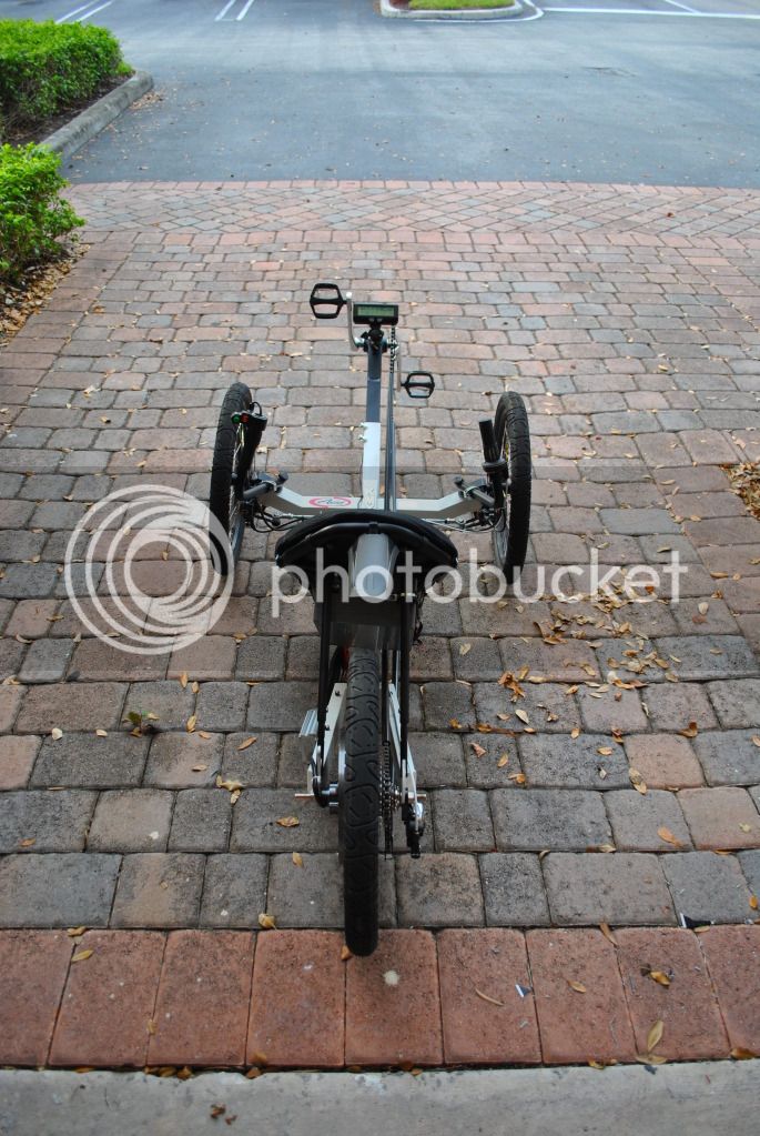

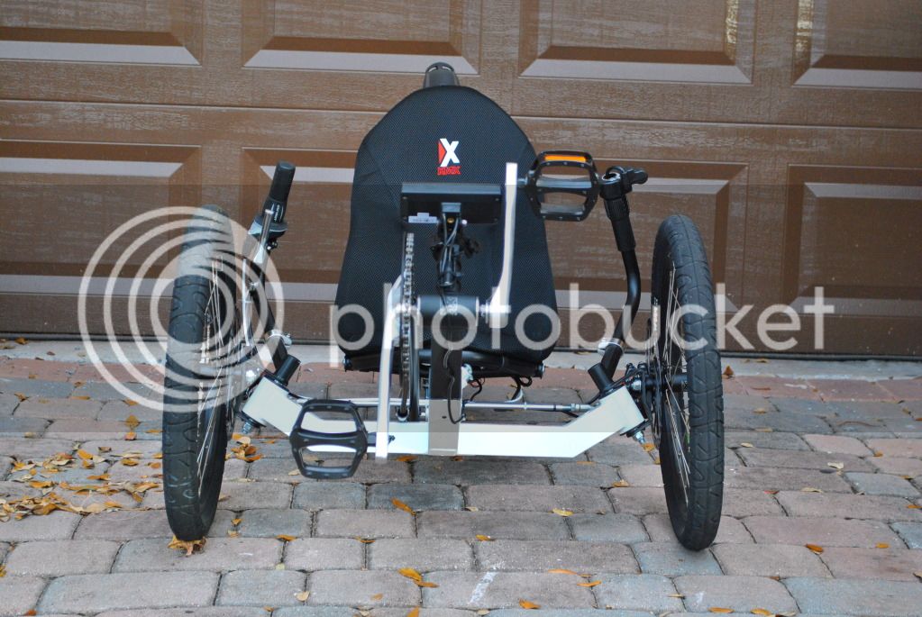

KMX trike build (updated pics)(new HD video)
SamTexas said:
Looks nice. So around 22wh/mi. What are the max and average speeds?
I saw RC LiPo in your battery box!?? I was expecting A123 26650 cells. What gives?

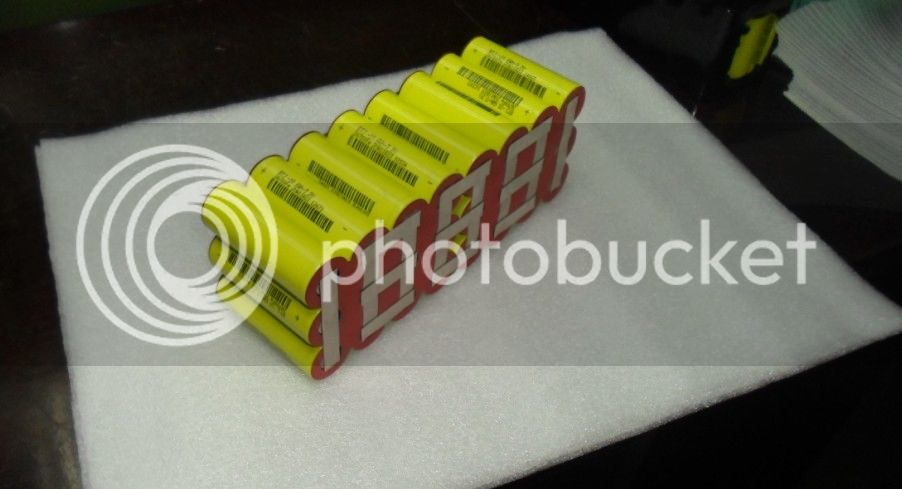

Hahaha! That's funny how you say it. I really have near 300+ packs left but the problem is I don't have enough time to put a pack together like solder the cells and etc. I even posted on the wanted section to pay someone to make me 3P packs with either a spot welder or soldering ... it appears we are all too busy!
The lipo pack is small and I think it will serve its purpose for now it is a 12S2P made with turnigy 6S packs 5AH.
Max speed is around 32-33mph using lyens 120% setting although I don't really keep it that fast since I'm still getting used to it. Average speed I think was like 21mph since I was riding thru some urban areas where they have speed bumps but there were some straight roads to hammer the throttle.
BTW the torque and power this thing puts after 20mph is impressive I can't imagine this thing running on 88V ... I originally intended to run it @ 88v but after using it like this to be honest I think it is more dangerous than useful. Instead I'll make a really thick torque arm and increase the amps to 60 or 80 and have lots of fun.

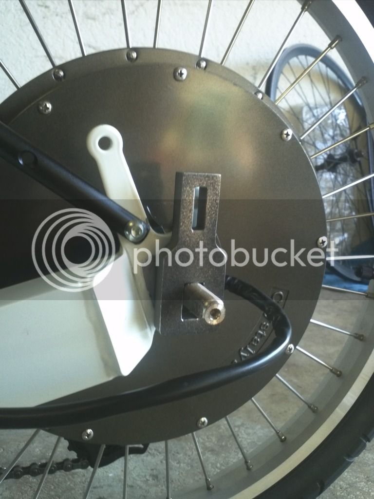

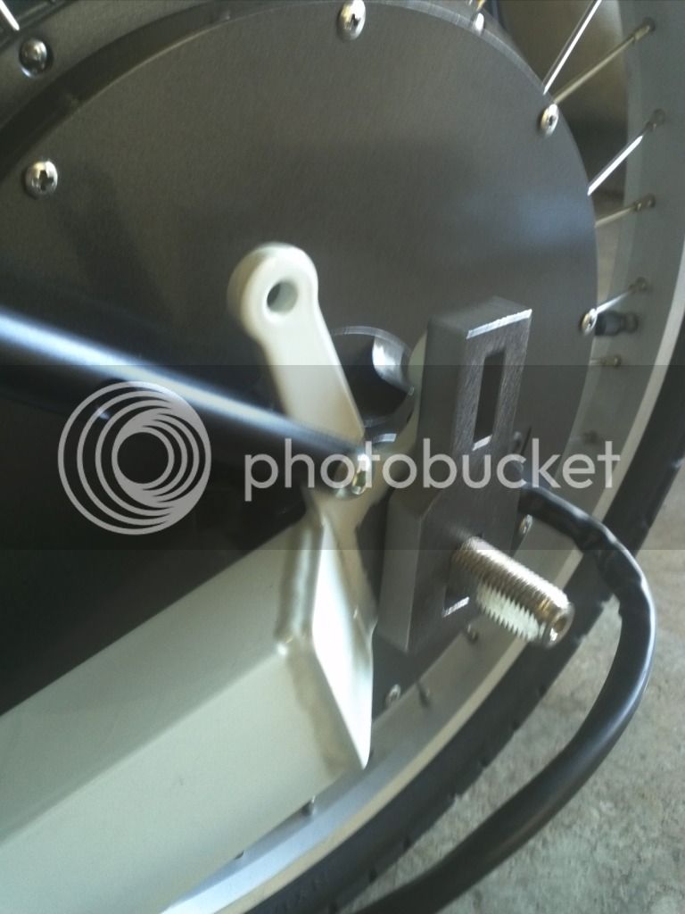

migueralliart said:
how have you got the CA mounted ?
that's exactly where i want to mount my CA V3 on my trike. i havent ordered the CA yet. waiting for the V3 final FW.
there's not a whole lot of clearance for the cranks....

hi jason
This location was suggested by another member named Andrew. The only thing u need is a really wide bottom bracket. The stock CA mount works perfectly.
The BB size is 68x122.5 with this size I can pedal comfortably and hard and I never hit the CA. It just seems really close to the cranks but if u see it up close no matter how hard u pedal u won't make the cranks hit it.
The CA I got is a V3 so far no problems. I got it from methods.
Thanks for the info.
My BB is only 116mm. I'm not sure ill be able to fit it there. :(
Might have to rethink my installation location. I did some quick measurements
Based upon the dimensions of the CA and I thought it might JUST squeeze in.
But based upon your BB measurements, I now doubt it will work in that location for me.
Time will tell I guess.
Thanks again.
Jason.

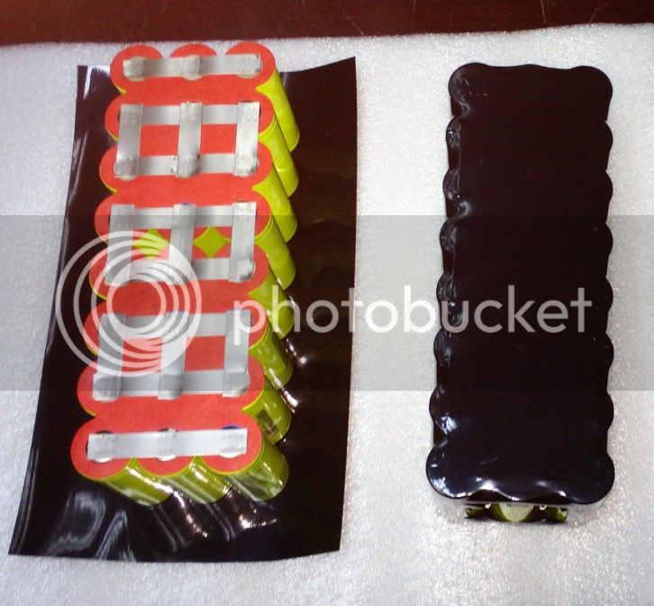

It's been a while since I've updated this thread. So far the KMX trike is being used 2 - 3 times a week to commute to work. I found a bike trail that's several miles long and gets me to work safely.
I wanted to migrate all my bikes to lifepo4 but I didn't have time to make the A123 packs for all of em so I checked the OSN power cells that APRIL on ES is promoting. I sent her a 3D image of what I wanted and she confirmed with the price quote. I gotta say the service was excelent and I have no complaints. The new pack for the trike is a 16S3P pack of 3.3 ah cells so 9.9AH. I asked april to split the packs in two 8S3P so that I can do the final welding of the balance wires and discharge leads. Here are the pics;
I will update the thread once I receive the packs and assemble them into the trike enclosure for permanent mounting a thing I was not looking forward to do with LIPO.
