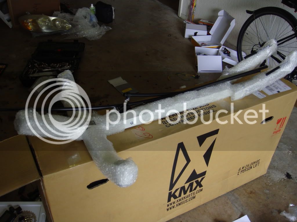

Yup it got to me ... as much as I tried holding back on this I HAD to order me a trike kit from utah trikes.
Took the hint from andrew.box and ordered a frame kit with double wall rims (20") on the front. I think it is better this way but I'll end up buying the brakes I want and components I want.
Bought a crystalite HS3540 from method's like 3 weeks ago on a 20" rim.
My plan is to run this thing @ 20S lipo or maybe 18S lipo still trying to figure out which one.
I bought the controller a while ago and it is being modified by amberwolf to handle more current and bigger phase and battery wires. Fets are going to be replaced too.
I'm working on a 24S a123 monster battery for this thing but in the meantime I would like to start with 3 6S bricks from hobbyking for easy hookup and testing.

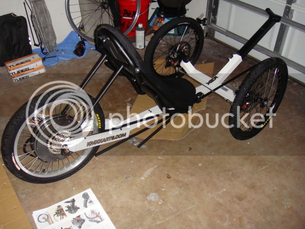

UPDATE Oct 6,2012
Well some updates and pictures as promised...

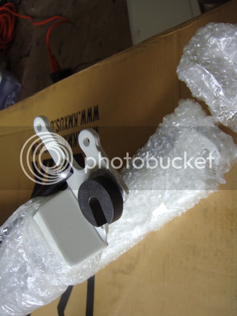

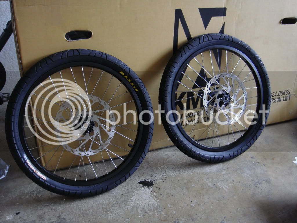

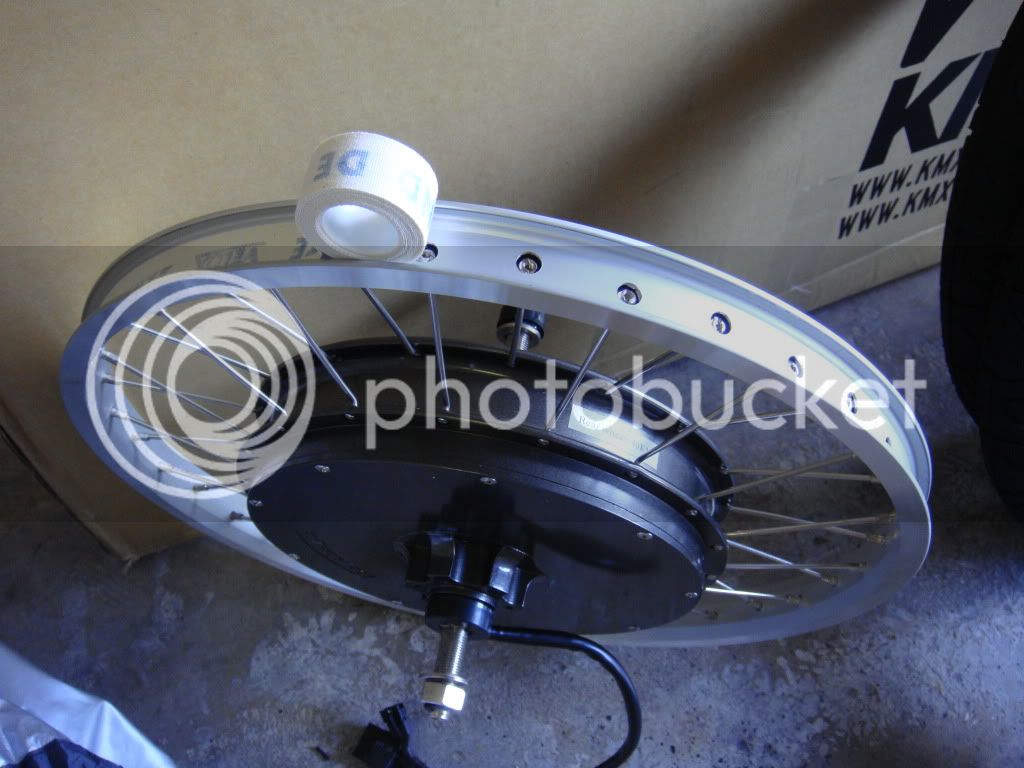

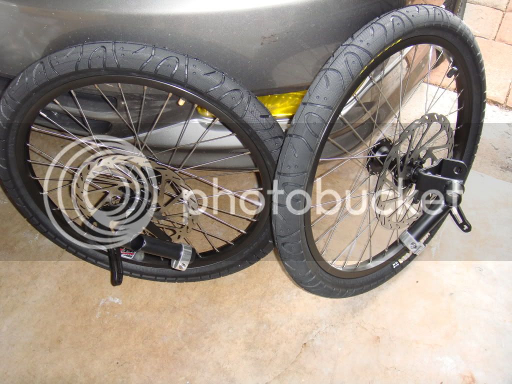

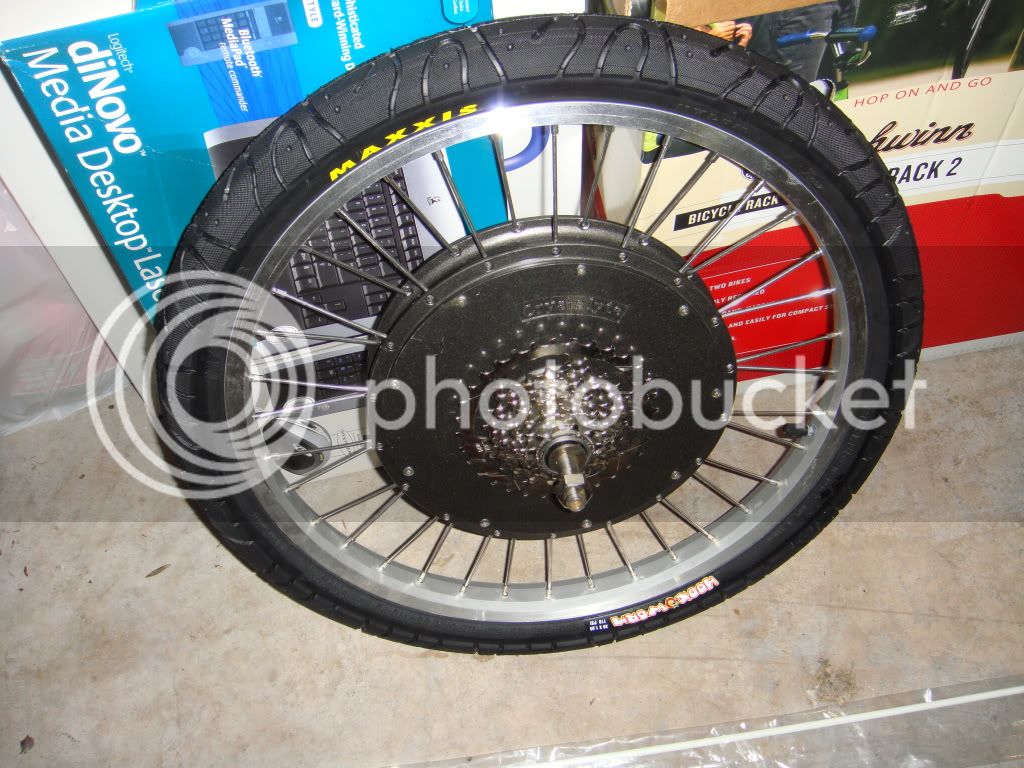

Prepping the HS3540 and front 20" rims

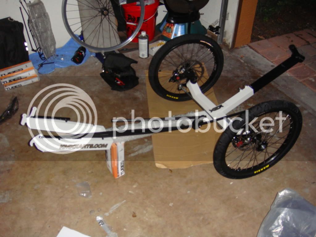

Front disc brakes and spindles attached plus tubes and tires

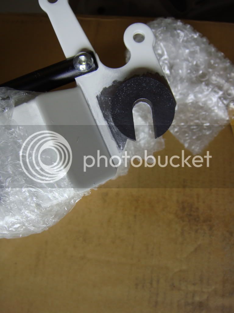

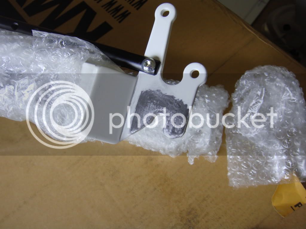

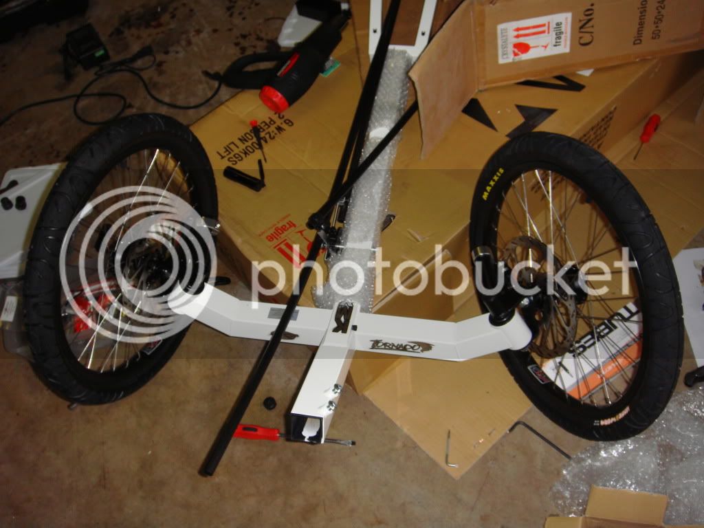

Frame is out of the box to be prepped for the torque arm installation using the DP420

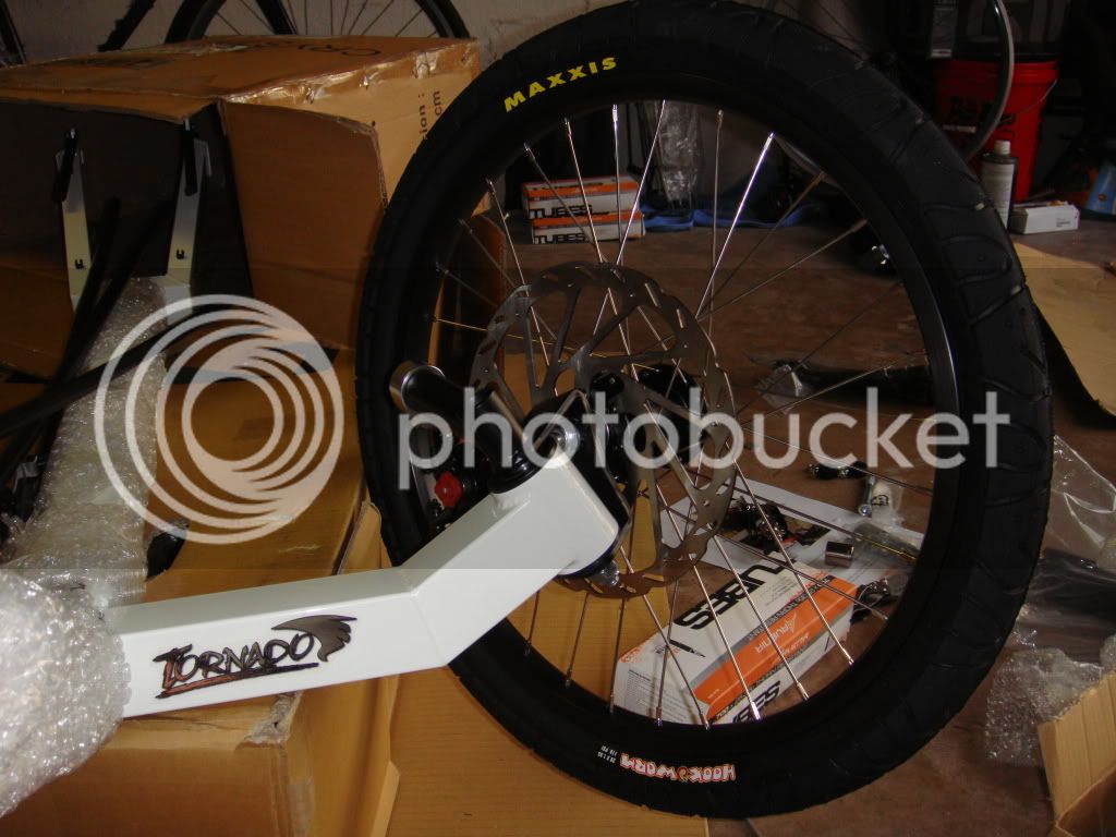

Front left wheel installed
Both front wheels installed

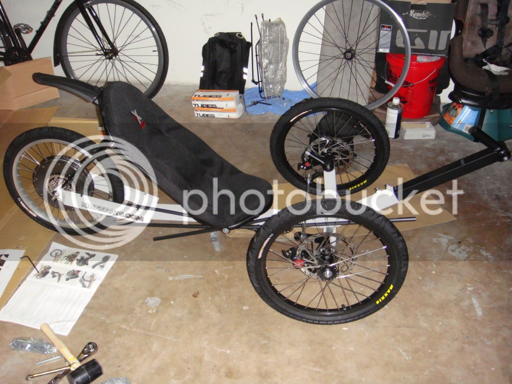

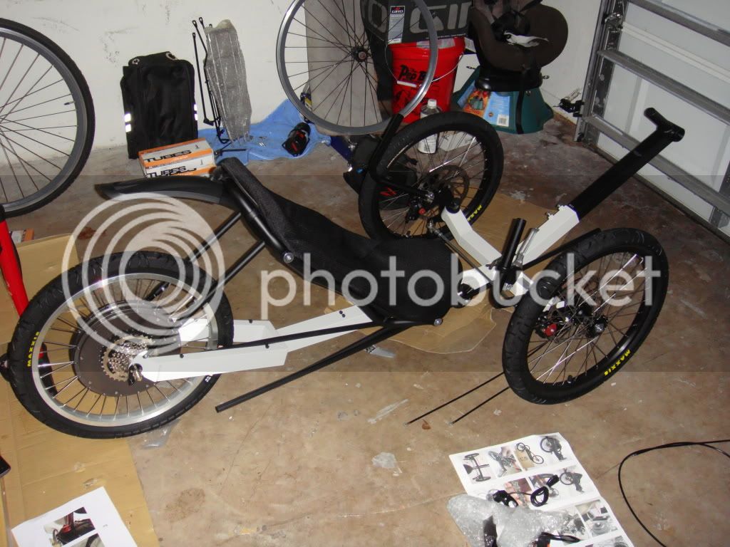

Seat installed too
Added the freewheel to the HS3540, had to make a spacer out of a washer I had
Some bonus pics
The torque arm I left curing with a heat gun and a carton box @150F for about an hour. Thing is solid now :D

It is running now .... not electric at the moment but everything else runs fine. I'm gonna tweak the brakes and add the shifter cable.

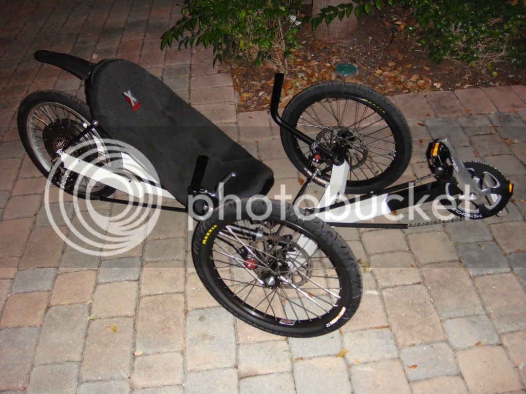

UPDATE Nov 17,2012
Well as promised here is all the updated pics of what I think is my new commuter in combination with my idrive. Enjoy!
And RIDE STATS
NO REGEN
LOTS OF START AND GO PULLS
NO PEDALLING
