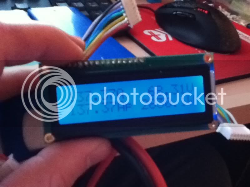

I just attempted this mod. I ripped off a couple solder pads when I was taking the boards apart. :oops: I tried my best to save the connections, and the screen still works. The only problem is that I'm getting 137.37a. The voltage is accurate and changing the voltage doesn't effect the amp reading. Running current through the shunt doesn't effect the amp reading either.
I have everything wired correctly. There was a small blob of solder near the shunt that I removed and it didn't effect the reading at all. Maybe I overheated the board when I was removing the shunt? Maybe messing up the screen is effecting the readout? I do not have pots in my meter to calibrate it.
Got any pics of the damaged bit of the board. Sounds like the current sense track is being pulled high, but these tracks are over near the shunt, not near the display you were desoldering.

I did remove the shunt. It took me a pretty long to take it off, and I was somewhat careful not to let anything get too hot. I could have damaged something tho...
The only picture I have is of the red board right after I separated the boards. I didn't remove the shunt yet- http://i345.photobucket.com/albums/p382/metallover1/IMG_0529.jpg
Hmm. That makes it hard. Where was the small blob of solder you removed? Which solder pads did you damage? If you can point to it on one of the photos of the PCB floating around, we might be able to help.

I appreciate your help! I broke out the macro camera and took a few pictures. They are all directly linked.
The first two show the shunt and my solder mess. Now that I look at it, it is a lot of solder! :| The third picture shows the damaged pads. One is in the middle and one is on the right. I cleaned up the one on the right so now it is not grounded to the screw hole, although I think they are on the same trace.
Looks okay so far. How about where the current sense wires connect to the main PCB.
Well crap. Better put a new watt meter on my list! :) I was messing around with it and the battery lead shorted out on the screen. It made a nice healthy pop. :eek: :(
Now when I plug it in the screen turns blue and it starts hissing at me. :shock: That's when I unplug it. :D
I took a couple more pictures anyway.. One again it looks like I did a crappy job soldering the wires onto the board. I think I should have used more solder.. But the second picture shows damage from the short- nothing looks destroyed on the board it just doesn't work.
