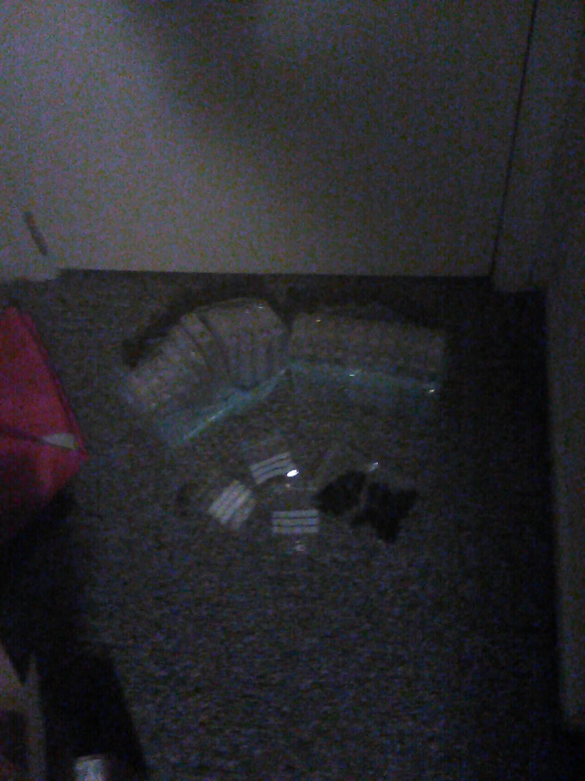

The package just arrived this morning. Will be putting together the 72V pack this weekend. I need to make a waterproof housing for everything, and also order some cables/connectors as well.
