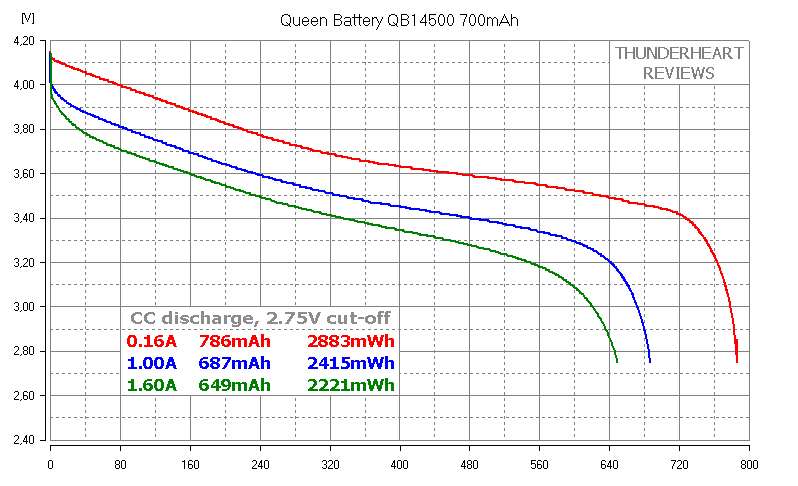

The battery was bought from my reliable supplier (Queen Battery) and tested with ZKETECH EBC-A20 and a self-made battery holder. It's a PC-connected battery tester supporting 4-wire measuring and discharging at up to 20A.
I've used version 3.0 of my battery holder based on 0.5mm thick pure copper terminals
I've followed all the prescriptions of the IEC61960-2003 standard concerning battery's capacity measurement. Before each discharging cycle each battery was charged at standard charge current mentioned in its datasheet to charge end voltage. Before each discharging or charging i've held a 1-1.5hrs pause. The environment temperature was 23.0-24.5°C. To be sure in results i've done each test minimum twice (usually 3-5 times).

Measured DC IR at 800mA in fully charged condition was 51±7mΩ (measured using EB Tester Software's Resistance test feature).
Measured weight of the tested cell was 18.17g and the actual dimensions - 14.0×49.3mm
Capacity test results:
At 0.2C/0.16A QB14500's capacity is noticeably higher than 700mah - 786mAh. I think 86mAh is a good difference for such a small cell. At 2C/1.6A this guy showed almost 650mAh and the curve still looks good though i'd prefer to not go above 1A.
Queen Battery QB14500 surprised me a lot. I didn't expect such positive difference in capacity. All the curves look excellent and the only disadvantage i could name is the 2.75V discharge cut-off voltage which means that you should carefully choose the BMS.
