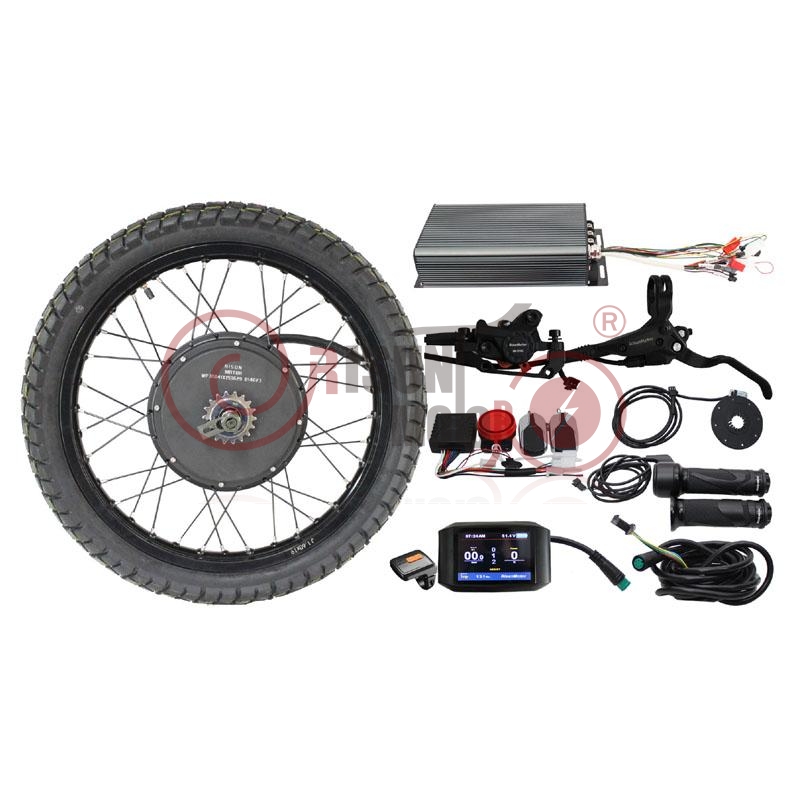

I haven’t verified what temperature sensors are in the motor or controller. I was hoping it was all compatible as it came as a kit.
The resistance between white and black on the motor hall connector is 900 ohms at ambient temperature which is currently 10C, so that points towards a KTY83-122.
This is the kit:
Well we can forget about motor temperature because I just noticed that although I have one white wire on one hall connector from the motor and a transparent wire on the spare and both measure 900 ohms at 10C, there is no wire coming out of the connector wired directly into the controller. So my motor temperature isn’t being monitored by the controller. Unless it’s by telepathy.
At this time I am not willing to trust the controller has a high temperature cut off either, so it looks like manual monitoring and control is a safer bet for both of these parameters.

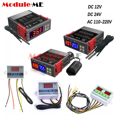

This could be the answer. Using the ST3012 dual temperature controller and setting both outputs to trip the low brake at 90C, or maybe set the motor a bit higher at 100C.
I would have to fit an NTC 10K sensor in the motor, but that will be easy enough and I could use the white and transparent wires to connect it to the ST3012 because they aren’t doing anything useful at the moment. The controller would be easier, just need to bolt a sensor to the heat sink.
