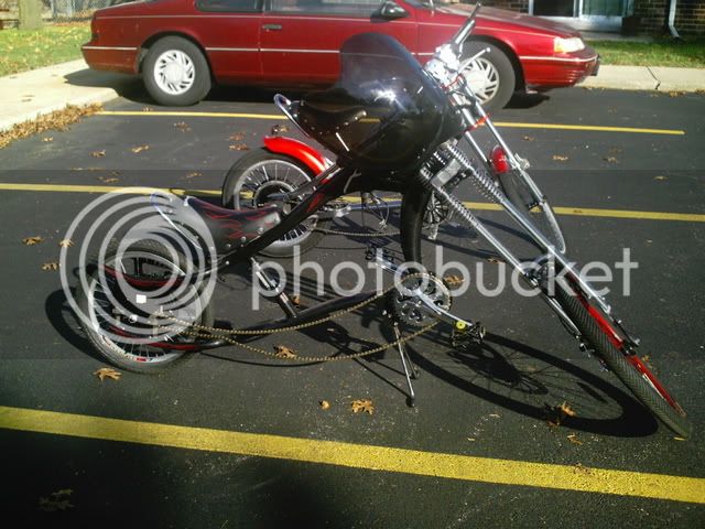

Schwinn chopper ebike buildup questions

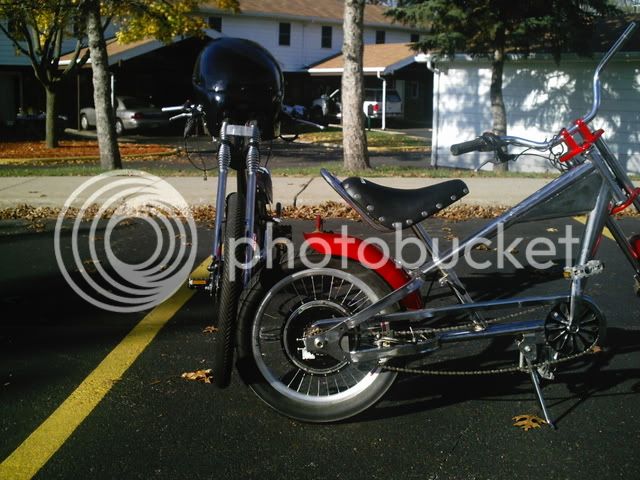

Nice rear on that bike, I was more attracted to the wide tire of the spoiler but if this works for you then that's great, but wouldn't a wider wheel provide more stability?
also in my opinion it didn't look bad with all of the washers but I would assume there was alot more movement to them then what was wanted.

AHH,you lost a fender support arm. Heck, you could use a nut and bolt as a temporary solution. The only reason I'm not already sending you a rear fender, is because of the inflated value I place on one of these bikes in stock form. A rivnut wouldn't help that issue much anyway. You just need another rivet put on. I wonder if you have a local independane bike shop owner in your area? We have one here, but I can't stand behind his work. I have a red OCC fender you could use. Just paint it black, and you solve two issues for the price of one. Decent fender, and you no longer have to remove it to get the wheel off! :D If you want it, you can have it for $20 plus shipping, total mabye $40 at most. If you want, I can even throw in some Ebike stuff for you for free.

Thursday the :shock: {plastic} boxes show up. :oops: I was sure they was aluminum. Oh well, they hold up the Spoilers rear, and that allows access to the toolbox that had that job. :D

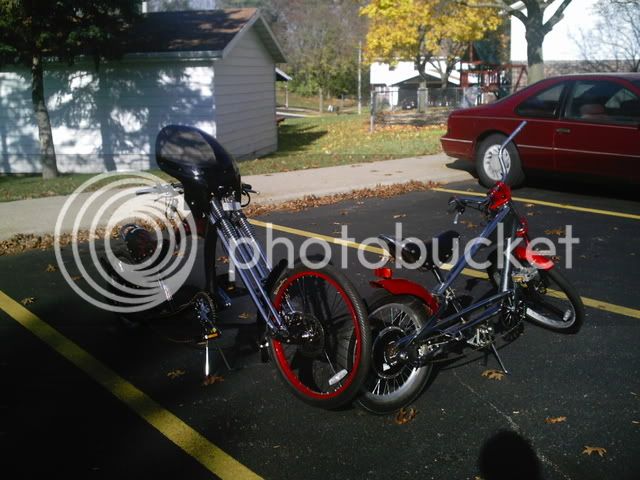

Thanks to the swiftness of the USPS, I now have two more pieces of eye candy to photograph, when my batteries finish charging. One of these days I really should invest in a decent camera. Today I recieved two Lyen controllers. The original Hyena 66V unit that was send out for modification, and the new $200 88V 75A 18 fet unit that I ended up buying anyway. I can't say enough about the way Mr. Lyen worked with me to resolve my issues, and stand behind his work. Two more big items off the list. Another item is being built and should arrive next week. I will post pics when ready, but I figure you all know what a Lyen controller looks like. I'm gonna post em anyway to document their arrival, and because I'm so proud of em!
Brian L.
Hi Brian,

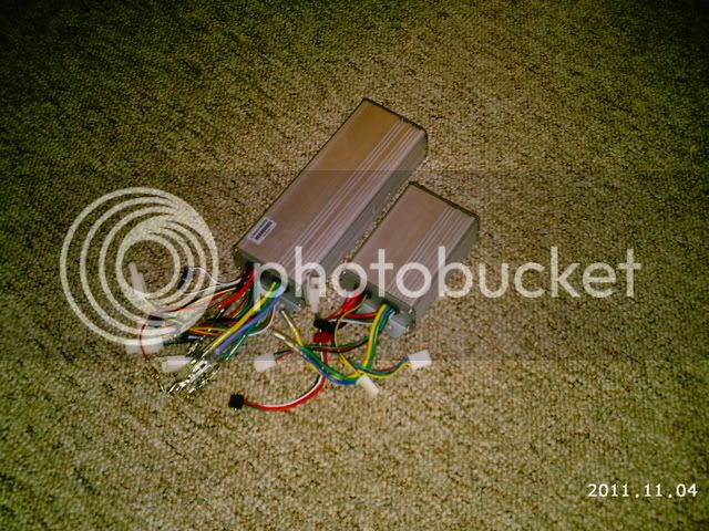

Good to see things are comming along with both bikes - new wiring harnesess from icecube57, and controllers from Lyen! Money must be burning a hole in yer pocket :)

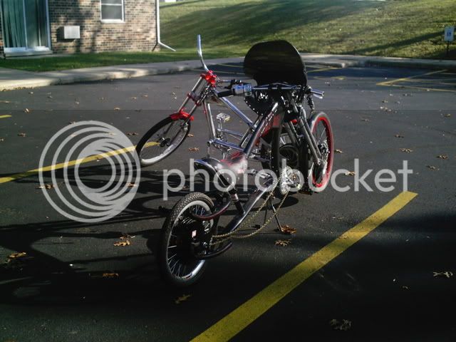

Nic pics of the spoiler though Im not to keen on that skinny rear wheel! Ithink it spoiles (no pun) the look of the bike, i prefer the BIG fat rear tyre.
err, that chain looks a bit slack I hope your gonna fix that :lol:
Once you get em both road worthy you'll be spoiled (again no pun :) ) on which bike to ride. No matter which you choose I imagine the Egrins with be big and last all day while riding. Be carefull you dont get bugs in yer teeth :mrgreen:

Geez Tom, I thought the dragons or the crusades might have done ya in man. Haven't heard from you in a while now! What ya been doin? That chain is loose cause there's no freewheel on that wheel yet. I been workin out the brakes and tourqe arms. Still waiting on some parts there but that will be done by springtime. The rear tire is a cheapy I got local so I could roll the bike arround. That wheel will be going out to JRH to be relaced with a wider chrome rim, and a fat DOT tire. Then it will look right as rain mate. How is your project doing?

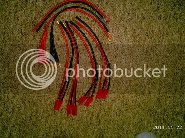

Happy Turkey Day all, here's the new 4S 2P harness delivered earlier this month. Ice does a great job on the copper, I only wish my cam was as good. Looking for a bigger harness for the Spoiler soon, but this one should get me to the store and back. Can'y wait to use it. Cheers.
