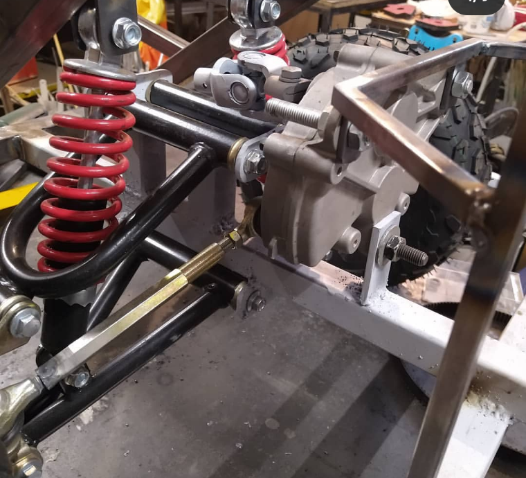

so we cut the quad axle i bought in china (together with all the tires and the front suspension assembly) and cut the lawn mover axle:
and then joined them to one 80cm wide axle with differential:

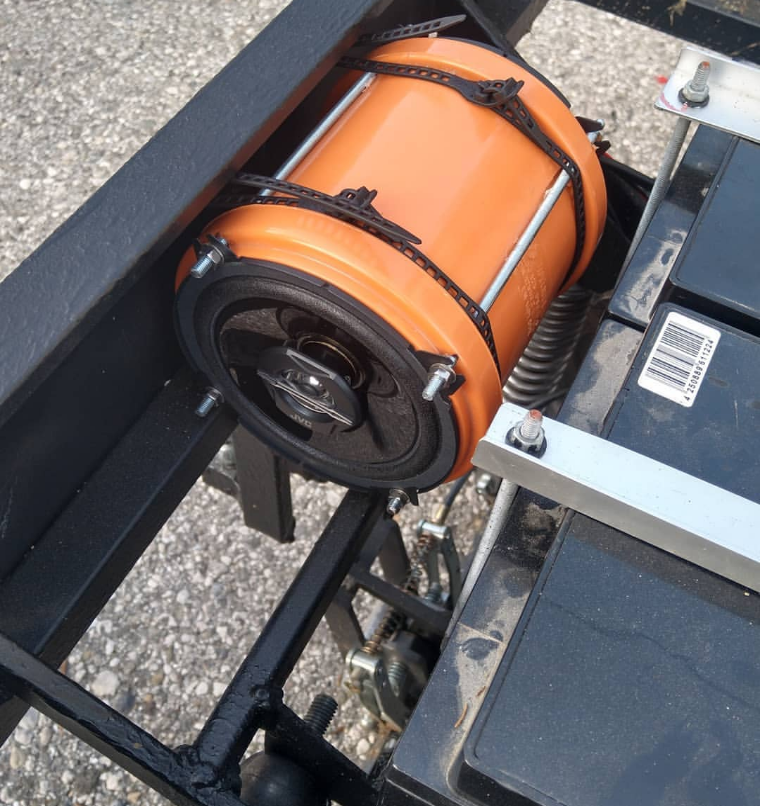

the motor used to drive a hydraulic pump in a forklift. it is a brushed 80v 3000w unit.
sadly the output shaft was a bit shy:
so my friend threw this awesome thing together:

because of our cabover design, the steering would be the wrong way round, so one of my friends designed this:
and had it milled it at another friends place (the gears are off the shelf parts):
steering box (aliexpress utv steering box):
motor mount:
we go from engine to gearbox via toothed belt (because chains dont like to lie down and the gearbox has a vertical input shaft at the bottom) and then via chain from gearbox to diff/rear axle

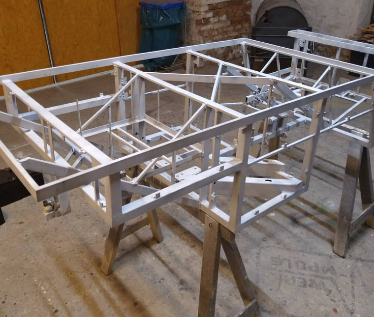

after more welding:
after some more welding gases:
primed chassis:
test assembly:

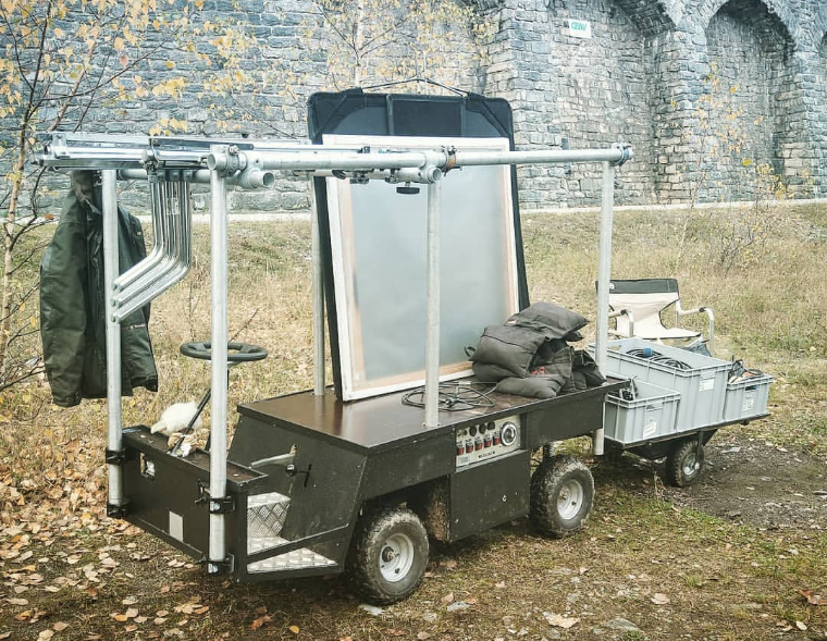

as it has 48,3mm speedrail clamps built in, the finished product is rather modular,
here as an equipment Hauler:
or here as a moving platform for a stabilized camera:
