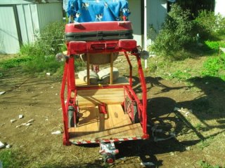

A few more things finished/fixed today:
--the top rack over the cargo deck has been resting on the dog kennel, cuz I didn't get the front supports built yet. Finished that today, except for finalizing the bolt thru them to hold them in place (probably unnecessary with the weight on them, but...just in case). Without the supports, it just slowly crushes the plastic kennel. :(
--The back vertical supports *do* need a bolt, because they ahave to be held up a bit so ti's easier for me to get the kennel in and out (right now it is quite a chore to do so...while that makes it pretty secure in there it also is way too hard for me to change it out when I need to.
--I removed the other two older packs, and temporarily mounted just the "new" one where the old EIG had been. This takes nearly 50pounds off (though the new one weighs most of that, it performs better than both the others combined).
--Since I had two little brackets leftover from adding the front rack supports, I used them as chain guards on the segment of chain under the seat, welded onto the "downtube" and seatpost, so that I can clamp down battery packs or whatever else there without worrying about them pushing against hte chain.
--After I added the front rack supports, and raised up the rack an inch to clear the dog kennel better, the canopy was *just* too tall to clear the shed's doorway. :( So I had to take it off, then drill two new holes for it's support bolts an inch lower on the verticals of the rack. Now it fits fine thru the shed door, and also still sits a bit higher over my head. I'd like to add some sort of shaded sunvisor in front, that I can see thru but that is darkened for the few times I ride with bright sun low in the sky. (letting the canopy cover hang down a bit helps when stopped, but not while moving, and it blocks me from seeing traffic lights when waiting at an intersection (have to lean forward a lot or reach out and move it out of hte way).
--Had hoped to take the old keyswitch out, but it's going to take some careful work to remove it intact (in hopes of repairing it), rather than just prying it out (which will totally destroy it).
Tomorrow I have a few too many things to get done (groceries, etc) to do much with the trike, so tha'ts probably all for this week.
Forgot the pics. :oops:
CHain guards:
Rightside front rack support, which also acts as the front cargo area's rear support, and the fender's front support.
Finished rack supports:
bolt thru rear support
Whole setup, with flash
without flash, under the new yard light

Removed the HF LED brake light, and replaced it with an incandescent automotive 3rd-brake-light, whiclh looks a lot better and is about as bright, but mroe surface area. It's still just ziptied on, till it's tested thoroughly, then I'll bolt it on.
Trailer hitch was easy; I just had to trim off the front edge (so it wouldn't overlap the center controller (which is for the temporary left motor)), and drill a new set of rear holes in it for the existing bolts in the rear frame edge, then drill new holes in the cargo deck/frame up at the front edge of the hitch bar for bolts to go thru it's existing holes there.
I used carriage bolts, since the deck is wood they'll hold them in place, and have rounded tops that will let the cargo slide over them without catching on them, wihtout having to be recessed.
It's still got the reflective tape on it
The HF LED light is just ziptied to the bottom/back edge of the hitch bar, and has a lens from a "first alert" LED flasher beacon taped over it. It was used because it is meant to spread the light in the beacon to as wide an area as possible, and that's what I want on there, so it's visible from the sides as well as behind, and will kinda light up the area under hte trailer itself, too, when it's attached.

(despite the fact that since the seat has a bottom that's curved upward from side to side, and is strapped down only in the center, so it actually does wiggle around under me!)
Last two days' commutes same stats, except for on the way to work it was so windy it took almost 90Wh/mile.
Surprisingly, even with some of the really big gusts, I didn't get pushed around the road, or any tippiness, etc., even with the canopy on top.
