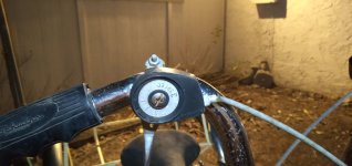

Today on the way home from work, while squinting to see in the gusty dusty storm wind, I could still tell that sometimes the turn signals were ceasing after a few blinks. Didn't matter if it was left or right, or when I was stopped vs moving (bumpy road vibration).

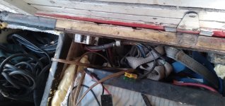

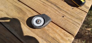

After I got home I hobbled around the trike to watch all the lights while running the blinkers (having to turn them off and back on repeatedly to restart them), and found that the left rear main hand-sized signal and the strip on the top cargo frame weren't working at all, but the vertical strip glued to the back of the cargo area was. Poking at the wiring inside the cargo area I found a spot that would make them all work when touched right, so that was the first thing to fix...but it didn't have anything to do with the other problem, unfortunatley.
That turned out after an hour of testing to be the blinker unit itself, which is inside the "front triangle" above the pedals. It might be a bad relay in it, or it might be the electronics (it's one of those LED-compatible electronic ones, a Novita EP35 like this: https://www.autozone.com/electrical...ID=120054150001289080&CADevice=c&gad_source=1
I thought I had bought one to use on the Cloudwalker Cargo Bike (that hasn't been started yet) but it's not in the parts box for that project, so I guess not. So since my brother has never used the trike I built for him (rode it once), I took the one off of that (which originally came from CrazyBike2) until I can order a new one for SBC, and that fixed the problem.
So another couple of hours of time and energy (that I didn't have to spare right now) used up. :(
The wheels and motors and controllers are still working the same, so that's good...but this coming weekend will have to be spent rebuilding the dropouts on the left side to properly secure the axle, instead of the growing amount of yard work and other stuff I still have to get done. (and the rest I won't get either, that I desperately need)

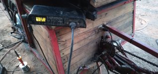

Aaannd, today:
On the way home from work, the motor temperature stopped reading, and then I started having problems with both motors starting up on their own after a stop, just a little, but if I released the ebrake I coudl feel both of them pulling...not enough to really get me moving, but enough to feel the slight forward push. Shortly after that the ebrake stopped working (it uses the same throttle input on the controllers, just in the 0.8v-0.0v range).
By the time I got home it was much harder pushing and I was having trouble controlling them at all. They felt like they were just always full throttle, not responding to the CA (which always had the, and I kept having to use the mechanical brake to manage speed.
Fairly classic broken-ground-wire symptoms, so easy to fix, right?
I found that (probably when I had to deal with the first repair this past weekend) the ground wire to the throttle splitter that goes to both controllers was about half an inch from the connector. Fixed that easy enough (though to get to it I had to roll the trike on it's side). While doing that, the entire JST connector just came off the base of the Y-splitter....so I wired it straight in. Then the JST going to each PR came off as I plugged them back in there...I didn't want to cut the JST's off the PRs (yet, anyway), so I thick-tinned the signal and ground wires, and pushed them into the PR JST contacts, then wrapped in electrical tape.
The temperature sensor's ground wire (which is just inserted into the center pin of the WP8 connector on the PRv6 as a temporary measure I'd forgotten to do anything with from back when I first setup the v6), had vibrated out, and without that ground to the CA, the other grounds to the CA apparently were insufficient (everything shares battery ground, which I would expect to be enough...but it isn't!). I thought I had the matching male WP8 connector but I guess I didn't actually order that (or I've misplaced it), and none of the other connectors I have fit it, so I just thick-tinned the sensor wires and reinserted them into the WP8 connector, then folded the wries back along it again, and wrapped the whole bundle in electrical tape, after first putting one layer across the face of the connector to help hold the wires in (which I didn't do the first time).
Verified all the voltages, then powered it up and tested, and it's working as expected now.

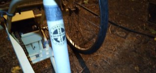

Another issue I've had since the new wheel install is that plastic tube is just not stiff enough, and more than once the one-link-too-short chain**** was pulled so tight from slight axle movement in the outboard dropout that I couldn't even pedal, and had to use the throttle to finish the ride to work or home, then roll the trike on it's side and reposition things to loosen the chain.
I poked thru my pile of steel tubing, and found some conduit that was just a hair larger OD and ID than the plastic spacer tube that came with the motor, so I duplicated the tube with that, and swapped it out; so far the wheel held it's position properly during the test rides around the lumpy bumpy backyard. Was too wiped out to safely do a road test ride. Hopefuly it holds up for my commute tomorrow. :/
Real fix for this is to rebuild the dropouts to make them both clamping like the right wheel's, but tahts just not happening right now.

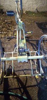

I just had noticed while checking out the layout of the frames we are looking at... it is a *lot* like yours, to the tune of probably 4-5hrs in my fab guys hands (I am no longer allowed to do welding, tremula in the left hand comes and goes with no real schedule, I was one of those weird people that never really got the whole handedness thing, I just kind of do whatever with both, and I also transfer tools hand to hand without thinking it through. Hence... no more big torches for me) But my fab guy works for Bbq on side projects so we are set!
I haven't seen anything that looks like mine, so if you have a pic or a link or a name I can look up, I'd be interested to see them.
What I really want is to build my new trike so it's like my trailer, with the cargo area hanging from the axles of tall wheels (rather than sitting on the axles of short wheels). Much better overall performance and is much easier on the wheels and the whole trike. Tha'ts the plan for the Mk2 version.
The general frame shape looks pretty similar, granted I am working off the images as ya see em. The benefit is that the whole rear end is set and blocked already, from my time in fab I just know that the welding, is enjoyable, and oddly zen for me. The set up to do all the fiddly bits in a project that is not only specific for minor angle variations, but is also gonna be in motion so any glitch that you miss...
I have just had the wild urge to ride, but the tremula is really bad this week, not sure it is a great idea to go out when my left hand keeps going into and out of circuit...
Well, almost any delta trike is "similar" to mine, but without seeing what you're referring to, I couldn't tell you if it's actually functionally close enough to be usable. :)

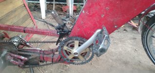

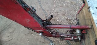

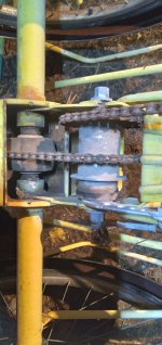

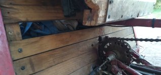

Oh, also, I did have one more problem Friday as I was about to leave work--I backed the trike (walking it by hand, no power) up to turn it around in the breakroom it's parked in while I'm at work, so I could walk it out, and a few inches after starting the rollback it just STOPPED, and I could feel the tension against my pushing as if it were a jammed chain.
I found no chain under tension, however, so I had to roll the trike on it's side in the breakroom, where there's not really enough room to do this so it ended up at an angle against a wall instead (and catacornered since I couldn't complete the backup that lets me turn it around from going into the room to going out of it).
What I found was that the allen wrench I had used "temporarily" to replace the sheared cotter pin on the transfer axle back in October '23:
had dislodged just enough to catch on the housing around that sprocket/axle area. Pic of the original cotter pin and the area below; I don't seem to have a pic of the wrench in place:
This is what the wrench looked like after I pulled it out with pliers so I could stick another one in there (it's the size that comes with practically anything that has to be assembled by the end-user, so I have a bajillion of them), which I wrapped in electrical tape until I could get home so it shouldn't move enough to catch on anything. The bending is from just this incident, since it has not had any such problems previously. (these wrenches are usually such soft steel that they barely survive the intended usage, and sometimes don't).
Plan was to do something to better secure it in place after i got home, but I was way too exhausted to be trusted with tools (probably couldn't have rolled the trike over anyway), and today I had to get started on the yard work, as it won't wait any longer; stuff is growing too fast in the suddenly warm weather after the rain we got. Probably won't be able to finish that either (got the back mowed before I was too worn out to continue, still have to do the front and streetside).

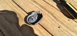

I've been looking for either a halflink or 18T freewheel that didn't make me cringe looking at the price...but there just aren't any single halflinks (even the junk ones) that are less than about $5 *each*, either actual item cost or item plus shipping, even on Aliexpress (my absolute last resort for anything I need to trust).
I did find freewheels on aliexpress for less than four bucks, but they don't have any removal slots (you'd have to disassemble it to take it off!) and most of them don't specify if they are "chinese metric" threading or ISO; some of them say they're 34-35mm, some even specify measurement may vary, which makes any specifications provided completely useless as you can't know what it will actually be.
I found "name brand" freewheels on aliexpress that do have useful specs and at least have pictures of the real thing in the ad (who knows what they actually ship out), but the prices are no different than the same thing on ebay or amazon, etc., and I'd have to wait weeks to get them.
So, I went with the cheapest freewheel with usefully good reviews on Amazon, that also has removal slots that fit one of the tools I already have; it's only ten bucks and will be here tomorrow (not sure i'll be capable of swapping it in after work though):
This same FW is found all over aliexpress, too, but any seller with actual feedback indicating they're probably safe to buy from charges nearly the same prices as amazon, and takes weeks to get it to me, and any potential return could be a nightmare (amazon returns are usually easy and quick, for almost any reason).
Freewheel arrived, appears to be just as described and pictured, and is packed in a thin grease (which has softened and penetrated/permeated the baggie it comes in, which itself is inside another baggie, and that inside the amazon-labelled bag, inside the bubblepack envelope it was shipped in...and all of them except the shipping bag feel greasy on the outside).
Is pretty quiet, doesn't have any play that I can feel, either laterally or radially, or between locked pawl positions back and forth, so it's already better than a fair number of non-major-brand freewheels I've used.
It's still raining outside, and I'm wiped out, so not going to get this on there today; more likely this weekend on a day off.
In the meantime I tested the fit on another UM cover, and it's perfect, not loose or tight. Did discover that my Park FR-6 tool is just a hair too small a borehole to fit all the way down over the UM axle, and a few minutes with a round file was enough to remove just the blacked surface inside the borehole and that's enough to easily fit on the axle now, so should be able to remove the other FW with it and put this one one, and put my original chainloop back, and fit the motor up into the dropouts normally without undue chain tension.

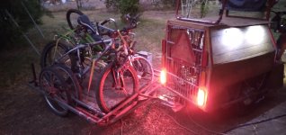

Yesterday I had just enough time to glue on and wire in a couple of the "white to yellow" 60cm versions of these LED strips
on the front edge of the canopy to replace the messy, view-obstructing****, and sometimes-breaking ones I'd installed on the handlebars from the mirrors down to the "brush guards".
**** Whenever they're lit, and it's dark enough, these shine on the trike, bars, etc., and unless all non-forward-facing areas and edges are obscured (tape, black silicone, etc) there's glare back to my eyes while riding.
Installed on teh top edge of the canopy, with just a bit of black silicone on the lower edge of the strips, none of those are a problem, and they are simpler, more visible to other traffic, etc.
As long as they don't get ripped off by a low-hanging treebranch like the last solid-white strip I had on there a long while back, they should do fine. :)
I'll post some pics as soon as I am able to get up and walk that far (probably not tonight), as I forgot to take any pics during install and testing. :(
Completely overcast, midday; these are still easily visible so make reasonable DRLs. With just power on, the white lights They're so bright at night I might setup a switch to cut in a set of diodes or a power resistor to drop the current to the white lights down for nighttime in close-encounter situations like parking lots.
The left turn signal on. The image makes them seem dim because I can't quite capture the full-on moment with the camera, it always catches it just before or after the "scan" has lit up all the LEDs fully. The turn signal starts with the rearmost LEDs lit first, then more and more LEDs sequentially lit forward and then to the center of the front, then cycles that repeatedly. (the rear ones are the same, but start forward and move rearward, and have red LEDs when no signal is operating instead of white).
You can see the clear tape still on there that I used to hold them in position while the silicone caulk cures. The LEDs are actually under the adhesive strip intended to secure them to the cars they're meant for, and are meant to just indirectly light up the edge of the silicone strip the lighting is built into, and just that edge is meant to show on the car, such as between the hood and headlight housing or trunk and taillight, etc.
They can't be bent to fit that way on my trike where I am putting them, so I have to install them with LEDs facing outward. I left the double-sided tape on the adhesive / LED side, but removed it's blue covering, to diffuse the LEDs a bit more, but it will age and flake off in the sun fairly rapidly. The stuff on the rear strips has come off long since, leaving each LED a "pinpoint" of light as seen from other vehicles when close to me, rather than a slightly more continuous strip of light.
There are other ways I could diffuse the light, but diffusion also dims the light, and I don't really want that, so it is what it is.
