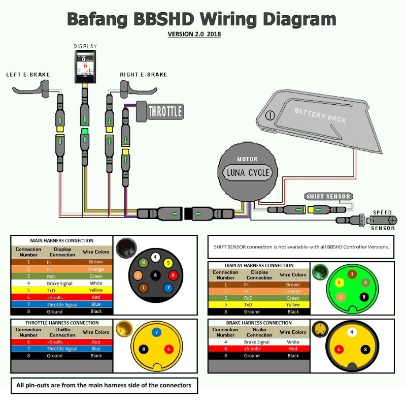

Over the Christmas break i finally got around to tidying up the wiring to transfer to a new bike, and decided to use a Bafang 1T4 cable. This bit of the wiki is a bit unclear, so here is the wiring option for making an 8-pin Bafang 1T4 cable work with the TSDZ2 8 pin. I just cut the Male end off the standard Bafang 1T4, and also a Female end off an 8 pin extension.
TSDZ2 Bafang 1T4
Blue Orange
Green Brown
Red White
Black Black
White Green
Yellow Yellow
Orange Red
Brown Blue
Of critical use here were the 8 pin HIGO image on the Github wiki, and also this Bafang wiring diagram:
Hopefully that will help with questions like above, and also as a replacement for the now out of stock cable from a couple of suppliers.
