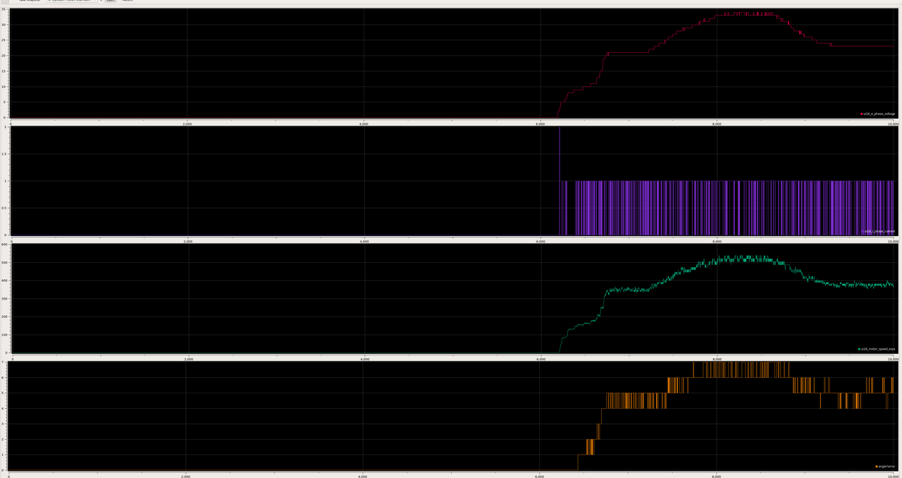

Got an experimental code working near what is expected - I will explain:
On purpose, I put an wrong angle value at startup and I see my motor asking to much current when I increase the speed. When I put a correct value of 0, it simple don't ask much current is about 0.6 amps on full speed and I think that is because it has low current/load.
So I put an angle of 10: #define MOTOR_ROTOR_OFFSET_ANGLE 10
Here the the experimental code, that calcs Iwl and V, than it does asinf and convert to angle values. Yes, I think some part of the code may not doing correct angle conversion.... can you please review?
The code prints the variables and also puts the negative value to ui8_angle_correction, that is used to correct the angle.
I did 2 tests, by keeping the ui8_angle_correction always at 0 (angle offset error of 10) or by apply the value calculated. I show t
he graphs and logged as also videos, where you can see the power supply current for each case and listen the motor noise.

FOC calculation disabled:
- speed ERPS = 450
- phase current = 3.5A
FOC calculation enabled:
- speed ERPS = 350
- phase current = 0.5A

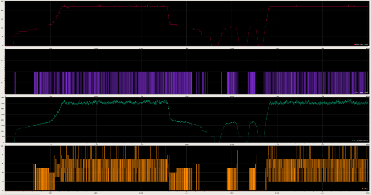

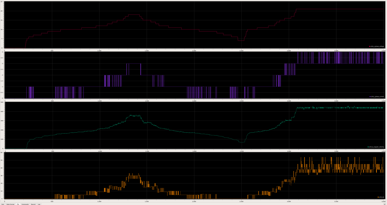

I tested again just to make sure it is working. This time I setup the initial angle as zero and the adjust FOC algorithm will put a negative angle value. I also decided to low pass filter the FOC calculated angle.
Also I did another test, I increased the the lab power supply voltage from ~36V up to ~48V and the phase voltage increased from 22V up to 34V (duty_cycle was kept constant but lower than 100%).
Here the results:
- 22V, I phase 1A, 350ERPS, FOC angle 7.5 degrees --> 16ERPS / volts
- 34V, I phase 1A, 525ERPS (4200RPMs), FOC angle 10.5 degrees --> 16ERPS / volts
So, the speed scaled as expected and FOC had to adjust the angle by +3 degrees. Also the speed is near the motor rated 4000RPMs (motor has 8 pole pairs).

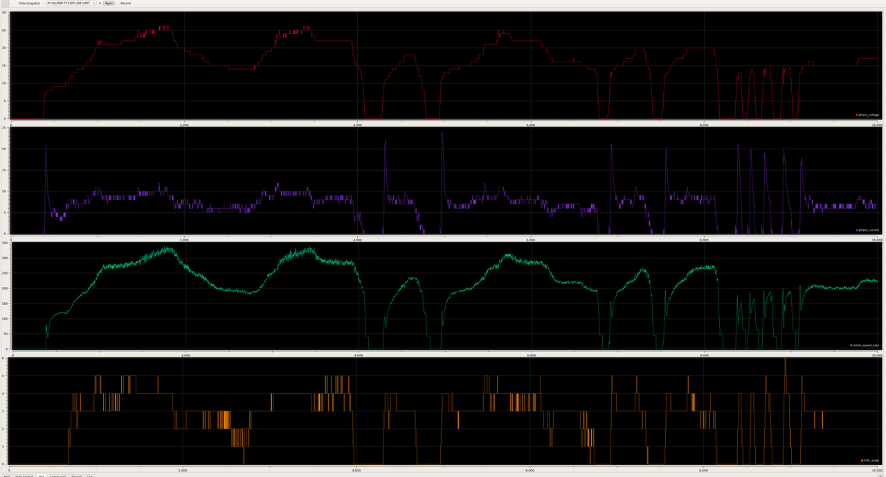

Here the graph of real time data, showing a session similar to that tests I did. You can see phase voltage, phase current, motor speed in ERPs and FOC calculated angle:

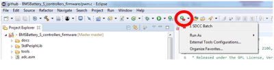

Don't forget you need to flash the correct option bytes to remove read/write protection and get the correct signals!
Just doubleclick on "WriteOptionBytes.bat" :wink:
casainho said:
Ok now you have.
I've updated the repo with the missing files and the updated windows makefile.
It compiles OK. The Start_compiling.bat can be run directly from eclipse via the "run external tool" button.
regards
jbalat said:
this is what I get when i execute startcompiling.bat from within eclipse
When did you download the repo? I've updated the LCD-repo just a few minutes ago.

nieles said:
about the openOCD, did you build the openOCD with the stm8 patches? (because it looks like it does not know the stm8) (same for binutils for compiling)
You mean on Linux? On Linux I just did follow the instructions. Also I think Ubuntu OpenOCD 0.10.0 already supports out of box the STM8.
Thanks for everyones help so far Re windows eclipse
Getting closer
I got this with the bat file.. below
but OpenOCD is the same. I guess I need to apply the patches ?? using this info...
https://stm8-binutils-gdb.sourceforge.io/
But I need some terminal window to simulate unix I'm guessing. Where do I get one from ?
Getting closer
So everything went OK with compiling, just the ST-Link was not plugged in, or the LCD3 was not connected. 8)
I can't say anything to openocd, I never got it running... (and I don't miss it :wink: )
regards
stancecoke

You are right I didnt have the lcd plugged and stlink plugged in.. Does that mean it created some bin and hex files for me somewhere ??
So the build button in eclipse needs to run this bat file ? Because at the moment it doesn't do anything...
So I don't really need openocd for making the firmwares ? From reading it says that its a debugging tool.
Someone mentioned that Windows10 has a unix interface you can install and that it may enable me to install the patches for SDCC
https://docs.microsoft.com/en-us/windows/wsl/install-win10
Getting there......... :)
You have just to plug in the STLink and connect the LCD3, then start the Start_compiling.bat. Then compiling and flashing is done automatically. You don't have to care about any hex or bin file and you don't have to use the VisualProgrammer. You can start the batch from eclipse via the run-button with the small additional red symbol if you choose Start Compiling in the dropdown next to the button.
OpenOCD is a tool that makes debugging easier, you don't need it.
