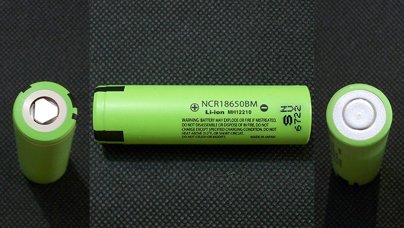

Panasonic NCR18650BM
My cell has the following marking: S NV 6722. It means that the production date is July 22, 2016.

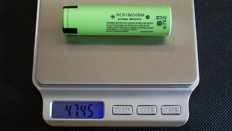

The measured weight of my cell is 47.45g. Measured DCIR at 3030mAh was 26.5±1.5mΩ (in fully charged condition, using EB Tester Software's IR measurement feature).
