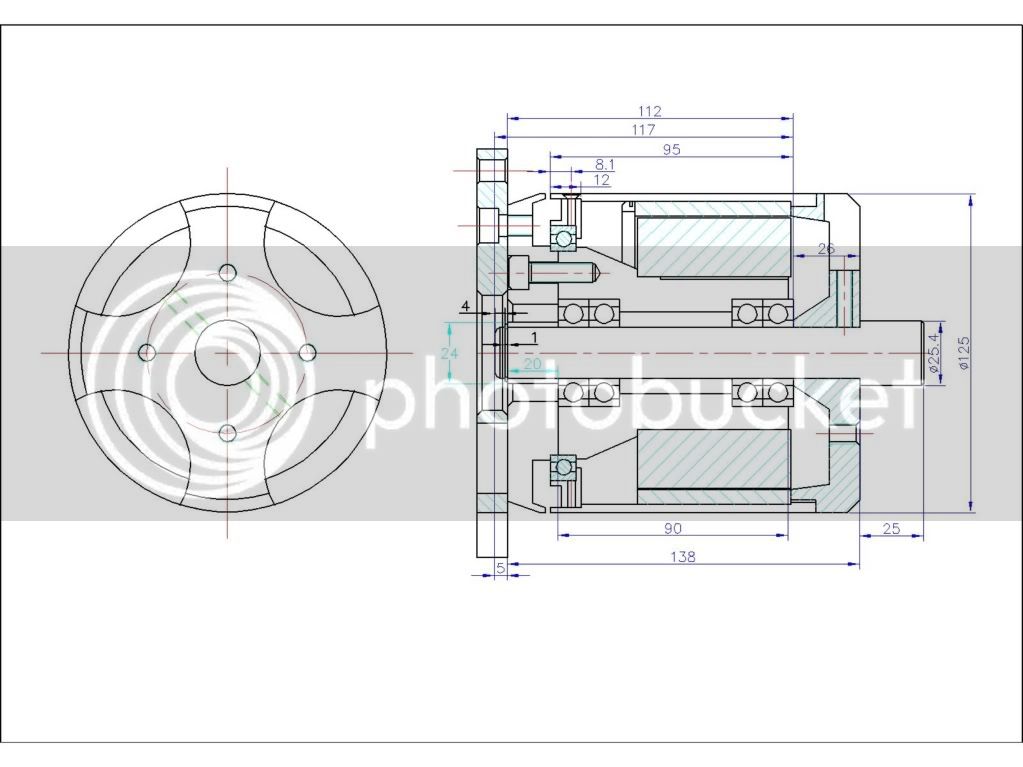

here s the motor picture
They will put high quality bearings , but no halls since they would need to open mould...
What do you say, opinions?

Fitting Hall sensors should be easy, especially as this motor has a fairly large stator. I'd say that fitting them as a DIY option is the way to go, all it'll take is for one of us to get one of these motors, do the install and then post some photos and instructions on here.
I may well be interested in one of these motors, so it may be that I'll be the Hall sensor mod guinea pig...........
Jeremy
The only thing that it seems to be missing is a shaft extending beyond the firewall side of the motor.
Taking power off of the prop side is more difficult. We may need to come up with a replacement shaft.
Looks great!! There will be a lot of folks intereseted in this setup.
Now all we need is a 200A 6 fet controller with hall sensors!
That definitely has double bearings on both ends of the stator.
In addition, it has a skirt bearing.
All of those bearings = Well Supported Shaft and bell. :D

4.5" diameter stator with 3" height.
If the efficiency is good, this single motor could easily be better than a pair of the big HXT motors.
