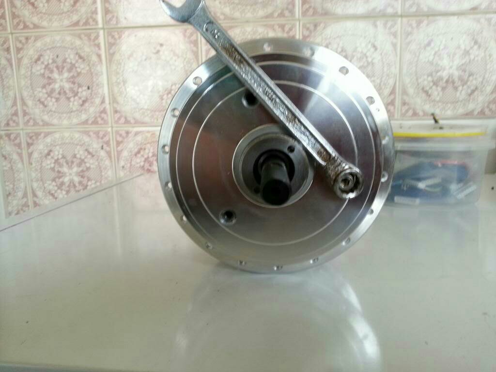

Can anyone on this long threat please tell me if they have a 3d drawing of the tool required to open this motor? IF someone could agree to share or sell me that 3d drawing i would share pics inside the motor.
By the way i dont jsut need the tool to open the motor and of course we can get it open and have had it open....
i want to have a tool readily avaiallable to custoemrs so in the event of a failure we can sent them the tool and ad replacment part or motor.

4) Have seen neither the motor nor the tool that you mentioned, but it may be like a "spanner" we used to utilize when adjusting old time bottom brackets. The tool is "like" Park Tool SPA-2 & SPA-6 "Cluster Cone Pin Spanner". Also put "Bike Hand YC 155 into your browser.
By the way i don't ... need the tool to open the motor and of course we can get it open and have had it open....
Here's a photo of Bruce Teakle's tool:
(From Here): http://bruceteakle.blogspot.com/p/it-seems-clear-xiongda-2-speed-motor-is.html
It is just a lever that mates with two of the motor holes, and appropriate length screws.
Alan, good find; that tool looks like what we used to use, but ours was either the SPA-type or Bruce's tool, but shaped like a "Y". His looks like it supplies much more leverage.

Eric & Alan, one last minute thing. The tool was basically a flat plate like Alan described with a "yoke" to go around the axle and a handle for leverage. The "ears" were tapped and allen screws a little longer than the thickness of the metal were tightened and protruded slightly. These were inserted into the holes. Sorry if I'm being too simplistic.
That's about right. As I understand it there are a couple of ways to get traction on the side plate to loosen and rotate it. The pin holes (or slots) and the screw holes. There are some differences between variations of the motor depending on whether front or rear types (at least). I would caution against using anything in the screw holes that doesn't match their threading. Applying force to the threads should only be done with a matching thread, otherwise the threads could be severely damaged.
I found one tool that levered the axle threads against the threads in one hole with a rectangular aluminum tube. I didn't link that (it is in this thread) because that could easily cause thread damage. There are also folks using combination wrenches to lever a capscrew against the axle (or the freewheel threads). Again this could cause thread damage. It would be better to lever against an axle nut, but the example photos didn't do that and it appeared to be levering against threads which concentrates a lot of force on their weakest feature.
The disc brake mount is on the wrong side plate, so that doesn't help.
I don't have one of these motors in hand to really inspect it, so I'm depending on what I can find on ES and elsewhere for this info.

Eric & Alan; I've never seen one of the motors, but the tool seems like the Pittsburgh Adjustable Pin Wrench (Harbor #36554); should make it non-adjustable since it's for one "spread" and with a longer handle for more torque. However, I could be very mistaken.
Here's D8veh method of opening a new unused hub.
I would not like to try and hit the spanner hard on a used hub in case I damaged the thread on the free wheel. Mine had done 1400 miles when I opened it.so I made a tool similar to Bruce's,out of some scrap I had lying around it all ready had the big hole in it and one of the small holes witch was slightly to big.I put some washers in that to take up the slack.I'm no engineer so any one with a welder grinder and drill could knock one of these together.
cycleops612 said:
Probably a silly suggestion, but maybe hold the disk brake hard on, and twist on the tire/rim?
As I understand it, the disc mounting holes are on the wrong side plate.
The black tool a couple of posts above looks like it would work.
Using a combination wrench as shown above that levers against the freewheel threads could easily damage those fine threads.
