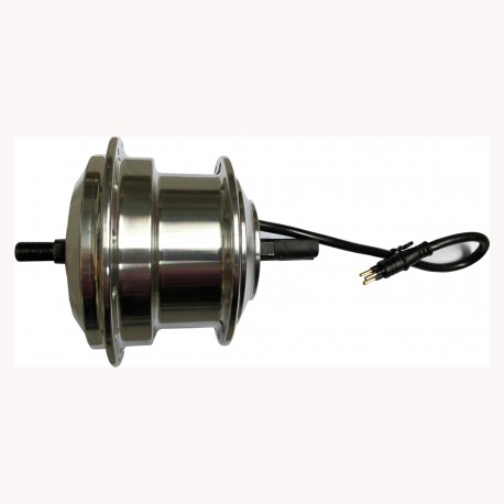

Hello
I've got a decent road bike, thinking of converting it to an eBike with a rear hub motor.
If I have a standard rear-wheel spare, I can use an acoustic or eBike by simply swapping the rear wheel, etc.
I don't need much power assistance, I would say 200W - 250W is enough.
My priority is low weight.
I've found the AIKEMA 85SXC 2kg motor, which claims to work in a 700cc wheel.
Any thoughts on this or other recommendations?
I'm in the UK
Thanks : )

Well if you really want light weight then I believe that at 1.2 kg (2.64 pounds) the Q75 may be the lightest weight hub available. Be forewarned that it is a 28 spoke hub.
https://bmsbattery.com/20-motor
https://bmsbattery.com/ebike/581-16212-q75-36v200w-front-v-brake-e-bike-motor-wheel-ebike-kit.html#/213-rpm-201
Another popular contender at 2.3 kg (5.06 pounds) is the Bafang G311:
https://ebikes.ca/product-info/grin-kits/bafang-g310-g311.html
https://ebikes.ca/shop/electric-bicycle-parts/motors.html
This is cool, is it possible to disassemble it and put it in a non crappy wheel? Is the weight of just the unit 1.2lg? And this is front wheel caliper only?
Cheaper to get just the hub. Then you can use good spokes, good rim.
Yes, I think so.
It doesn't look disc compatible, but some places say it is (though maybe they're just recycling text from other listings?)
That and other Q-whatever motors are made by Aikema. Topbikekit sells them as AKM-whatevers.

The q75 looks quite good, but I wonder what the absolute highest quality hub motor with best power/weight ratio is and where you start hitting diminishing returns, a 750w nominal 1200w peak hub that fits in a Brompton fold would help a lot, the e Brompton is heavy steel and the 350w stock front hub sucks, maybe rear hub is better, and the 6 lbs battery doesn't last long and mounts high on the front.
The Q75 is sensorless and that wouldn't be good on a single motored bike. And I'm not even sure if it will take a disc.
When I was knee deep in mini motors, I looked at everything avail. at the time and kept comming back to the Q100 (Love/hate relationship).
The problem with it, is the high-speed version (328 rpm @ 36V) is too high a range for wheels 24" and over, which leaves the mid-range 260. The best Q100 is the 260H w/ free wheel fitment. The cassette version has a narrower stator to fit the wide cassette and makes less power than the already less-than-powerful Q100.
280 or 290 would be a better speed range for road bikes w/ 27 to 29" wheels, but it, of course, doesn't exist.
All will benifit from over 50 V packs, especially bike using 26 or 27" wheels to get some top speed.
There are hub motors that are higher quality than the Cute (it isn't that hard), but they start at 2.4 Kg, vs. the Q100's 2.0 Kg.
