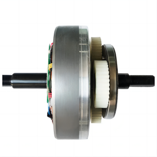

I got myself a kt36/48svprd-hrd01, 36/48V 20A max controller and a 36V 500W rear motor hub (with shimano gears).
As I want to increase range I'm thinking about upgrading from 36V/15Ah to 48V/25Ah. Would it work, or is the controller too powerful for my 500W motor that is rated for 36V? I'm mostly worried about uphill and so on where the load increases. I don't want to accidentally burn the motor while riding my bike one day.
If so, would it be better to downgrade to a 17A 350W KT controller but running it at 48V? Or can my 500W/36V handle 20A/48V?
As long as I reach a minimum 20mph (~32km/h) I'm happy, I'm mostly interested in range rather than top speed.

Can you post a pic of your hub motor, plus one of any markings on it? I assume when you say Shimano gears, you mean the cassette or freewheel. I'm also assuming that it's a geared hub, since that's what more 500W motors seem to be. With more info, you may be able to get a better match on the simulator.
EDIT: never mind. I'm looking at the one linked above.

The hub is all black, no markings just ''500W 36V'' 9-pin output. Hydraulic brakes back and front. 7-Speed shimano.
