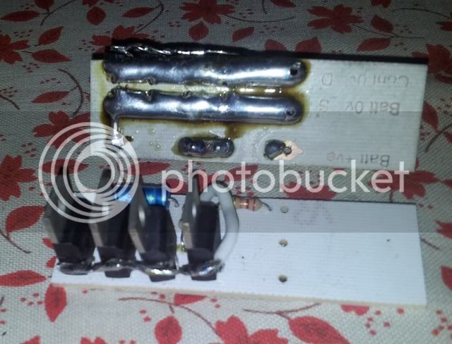

Hi,
I had a play around and made the Jeremy Harris FET based inrush protection switch.
It took me a whole day but I was stoked when it worked.
First time I’ve made a PCB since I was 15yo.
The bike is 15s lipo that peaks at 30A 1600W.
I made mine flat, soldering the FETs to the PCB trace. I used 3 x IRFB4110’s and they don’t get warm (on my short trips which are limited by the 5Ah pack on this bike, must try it with a bigger Ah).
I notched the powerpole housings so they sat flat.
Connectors are mirrored so you can’t really plug battery into controller socket on the board.
And a minor change was made to put a set of charge plugs next to the switch to make recharging much easier. And this is the final product.
And it slid into the small tool bag on my bike.
In hindsight I should have gotten a finer pen for the etch resist. Next plan is to learn to use one of the software packaged like KiCAD.
I might relocate the switch.
And if doing another one I would place the powerpole housings on top of the PCB rather than in line with it.
Thanks for the schematic Jeremy.
Greg

I've built a spare one you can have. It's got counterfeit IRB4110s, but the other two that I built with the same ones work perfectly and don't even get warm at 20 amps.
It looks like this one and you have to solder on the switch, which I mounted remotely, and the battery wires.£7 plus cost of postage:
