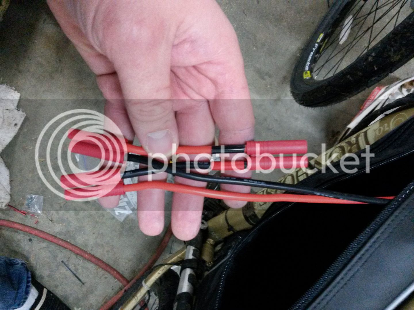

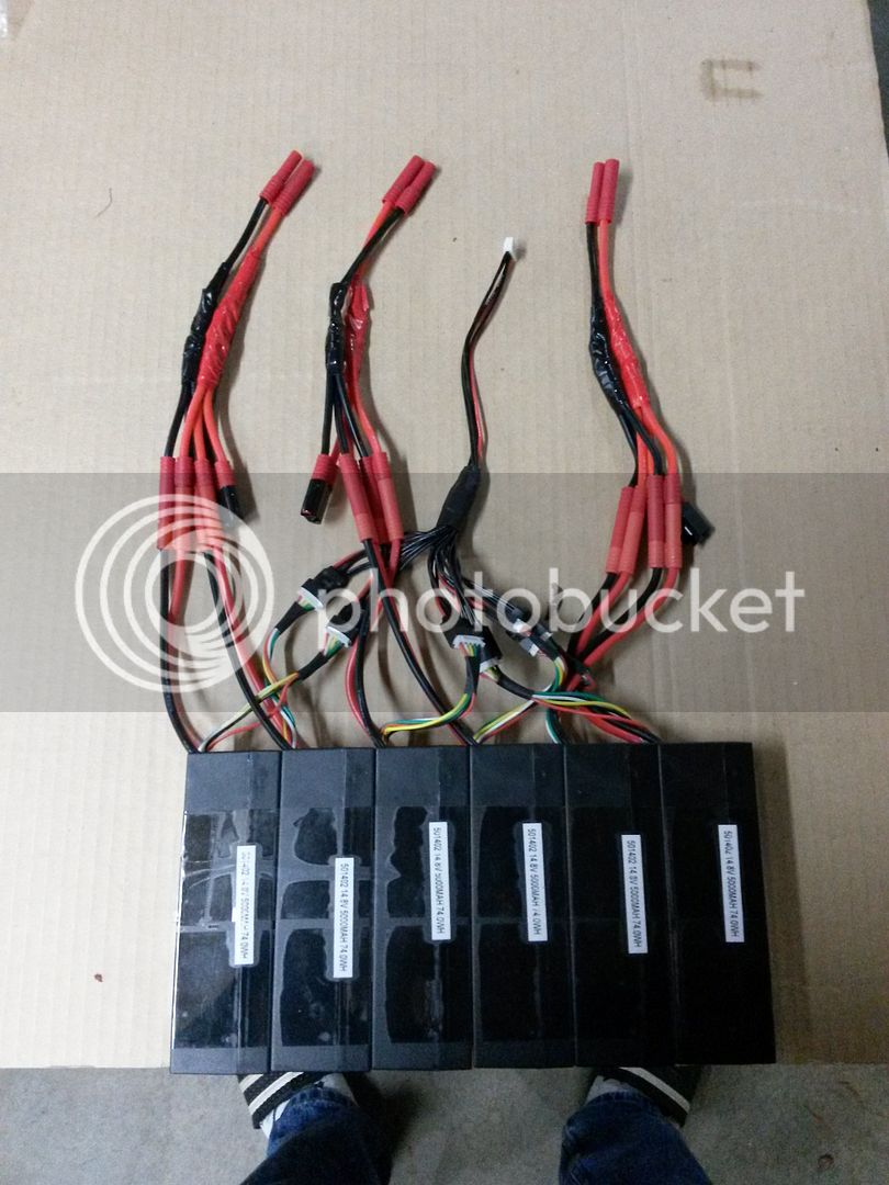

could you send me wiring diagram(or pic) for 12s 10ah setup 6hk 5000ma lipos?thank you,mike
It's just 2 Packs in Parallel and then three of those in Series.
Here are some pics:
First Step: 3 pairs of Parallel Packs: (note: REMOVE THE PARALLEL BALANCE LEAD CABLE BEFORE CONNECTING SERIAL HARNESS CABLE!)
Next step: Build A Serial Cable for the bike. Each of the output ends of the parallel Sets connect to a one of the bullet connectors in the Serial Cable.

You're on the right path with one HUGE exception.
I could use the parallel balance cable to attach just one of these alarms to all six of the packs
UNDER NO CIRCUMSTANCES SHOULD YOU HAVE THE PARALLEL BALANCE LEAD CABLE ATTACHED TO THE PACKS AT THE SAME TIME AS THE SERIAL CABLE.
This will create a short as soon as you plug in the cable and burn the S#*t out of your hands, and quite possibly the light off the battery as well.
This is the one operation you need to be very careful about with serial discharge & Parallel charging. Keep the Serial Cable attached to the bike and the parallel balance leads attached to the charger and never mix the two.
So it goes like this:
TO REMOVE FROM BIKE & CHARGE:
1. Disconnect Serial Cable from battery packs.
2. Plug Parallel Charge Leads into charger (or ALWAYS leave them connected to the charger)
3. Plug the Parallel balance leads into the charger. (or ALWAYS leave them connected to the charger)
4. Double check that serial cable is disconnected from the battery packs.
5. Connect the Battery packs to the parallel charge leads. (Cascading parallel leads are OK here, as long as ALL WIRING IS PARALLEL)
6. Connect the parallel balance leads to the battery packs.
7. Charge your packs (1S6P configuration in your case)
TO REMOVE FROM CHARGER & MOUNT TO BIKE:
1. Disconnect Parallel charge leads & Parallel balance leads from battery packs.
2. Double check that parallel balance leads are disconnected.
3. (optional, but good advice) Plug in LVC alarms (one alarm on each pack)
4. Plug Serial cable into battery packs (or in your case to the output end of each 3P parallel harness.)
The major risk you take with using LiPo (or any battery type) without a BMS is that you could forget to follow the proper connection procedure when changing from bike to charger, and vice versa. - The good news it that you will know right away if you did something wrong, as it will spark and get very hot, very quickly. - if that happens just start pulling the harnesses apart as fast as you can, starting with the one you plugged in last. - also if the metal connection welds together from the heat, the solder will melt as well, so you should still be able to get the wires apart.
