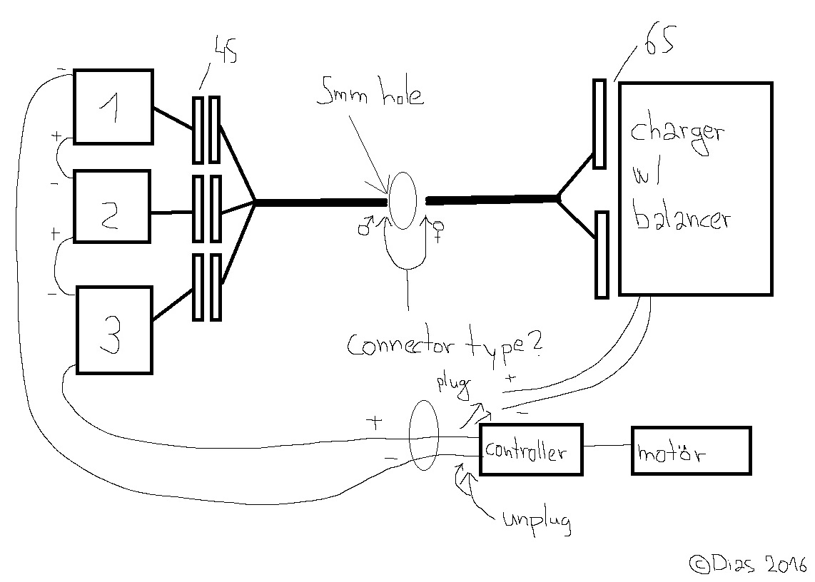

OK, if you want to use a 12s charger with 3 4s packs, you'll have to make an adapter as I did years ago. It's simply 3 4s plugs into 2 6s plugs. Here's how to wire it.
There's all kind of ways to safely charge rc lipo. This is just one. But if you don't have a 12s charger, then a bulk charger using a bms or battery medics is probably your best option.
You don't really need to monitor cell voltage while riding imo, just pack voltage. And that's just for a fuel gauge.
Thank you for wiring diagram, this I will need that for sure. But thats just one part...the other one is: how do I get wires out of the bike? I dont want cables (JST-XH) hanging out of my bike. I would like something like:
I just need to simplify the connector so I can easily plug and charge. Something like:
If I could charge and balance by just plugging charger to this connector, I could get a 12 balancing charger and use the bike without BMS with a simple monitoring device. I need to find a solution to pull this cable out of the bike to charge or make a waterproof gadget. Idk how everyone charges their enclosed frames. Havent thought about this before.
If your going to buy a 48v controller with display and wish the battery meter to work, your going to have to build a 48v pack. This is not 12s as is often said, as 12s is just 44v which will stop the meter working and limit your power for no real reason. 12s is the choice where a 36v controller is needed as they generally pop above 12s. If you do go ahead with 12s and a 48v contoller it's lvc won't let your cells drop below 3.5 which leaves a lot of charge unused. Remember these are 3.7 nominal, with half the charge available above 3.7 and half below. If you stop at 3.5 your still carrying a lot of battery your not using. While ensuring little of the cells life is spent half charged where it ages best.
Most BMS suppliers target 13s because 48v is a common industry standard. If you buy some old-skool design they generally won't balance till 4.2v per cell is reached, but if you buy a $20 programmable one you can have it set however you want.
