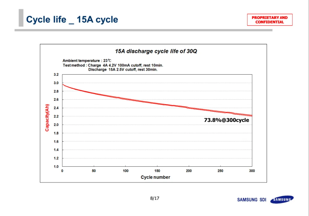

Battery: a 50v Triangle pack (14s6p) in either 14.7ah 25r or 17.7ah 30q. Charger will be the togglable 52v mini charger from luna.
I plan on running this battery consistently from 80% down to 10-20%. Accounting for the natural degradation of the battery over time, will the the 14.7ah 25r last me hopefully more than 2-3 years commuting ~3-4 times a week? I'm hoping to get a battery that will be able to power a commute even well into 100-200 cycles. Here's the power degradation charts for the 25r and 30q: https://cdn.shopify.com/s/files/1/0674/3651/files/discharge-25r_1024x1024.jpg?7306674405146565693 https://sc02.alicdn.com/kf/HTB11NncLVXXXXX7XFXX760XFXXXS/225565083/HTB11NncLVXXXXX7XFXX760XFXXXS.png

Dog and Rhino, thank you both for weighing-in! I think you're both right... I'm trying to do too much with this build and would be better served with a MAC.
Will the same class/size of battery serve this motor effectively? Should I aim for the 20, 25 or 30amp controller? Also, I'm thinking the 10T winding is the best bet for versatility but would love your input.

With a small stable of ebikes now... my everyday favorite is a MAC 10 T with 48v 11.8Ah Samsung 30q. Rock solid, plenty of power, just works. Build is old steel mountain bike, 26", no suspension. With terrain and use profile you describe, think it might work fine for your 29er. Motor, controller, CA, battery and charger from EM3ev with zero headaches.
Mac 10 t will work fine for your commuting needs, and pair well with your battery choice. 20-25 amps controller is plenty for those who still pedal. Pedaling and cruising pulling 600-800w (12-16 amps) is the way to make your battery last, and extend range. 25 mph cruise, or less. The geared motor will perform ok in the 29 er. It will last fine, if you don't overload it with trailers and climb a huge mountain. But it can still run a large cargo bike, loaded to 300 pounds including you, easy.
But later,, you will get the addiction as many of us do, and then you will be spending on a more capable battery, big motor, etc. :roll: Essentially, a small motorcycle. For that, a more capable frame too is usually best. Stable of e bikes is where you are headed. One for commute, one for fun is a good start.
Again, nothing wrong with going for that right away,, it just going to conflict with some ideas you have, like a small, light, affordable battery that lasts a long time. Big fun powerful ebikes tend to need new battery sooner. I get about two good years from a pack of RC lipo myself. After that, its not much good for anything but riding low power, or running my mower.
For safety and longest lifecycles { at a fair price} , lifepo4 is hard to beat. A lifepo4 battery that is properly taken care of, can last 1000 complete charge/discharge cycles and still maintain a useable output of voltage/amps. For anyone new to this hobby, I think lifepo4 is often the best ,safest and most cost effective choice
