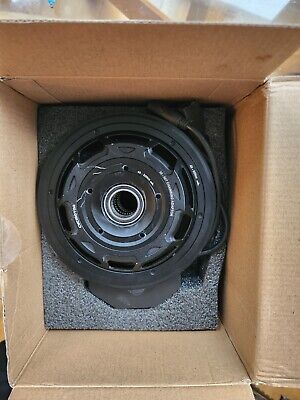

Don't forget cranks are missing, too.Can you guys with a Photon see anything missing from this apart from the spindle and leads? What goes where the 6 holes are?
Just a thought, is it actually one of you guys selling it?
CYC Photon Ebike Motor 48V 750w | eBay
For sale is a used 48V 750w CYC Photon Ebike Motor, 38T chainring, and SW102 display. Nominal power is 750w but it can peak at 2000w. 110Nm of torque.www.ebay.co.uk
Just like other companies when dealing with claims, doesnt surprise me that CYC is reluctant to send new parts before the old are returned for inspection to see if it is a fair claim, and I dont blame them.
Seems the guy was sent a new motor and display under warranty after a complaint, and now he is selling the old motor as fully working because all he needed was a display.
If it only needs a spindle and lead then do you think this is a good buy? Seriously thinking of it to avoid the waiting times.
