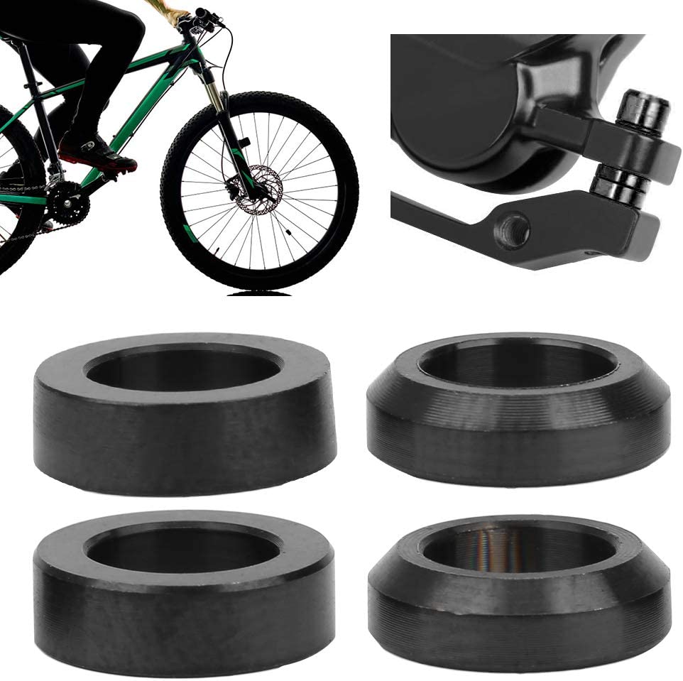

Wear pattern suggests that alignment washers are missing between the caliper and frame mount.

By the way, I went thru all my boxes and tool ases looking for those doggone concave and convex washer spacers. I was just going to buy some when I saw they were $4 each online. Maybe less at the bike shop, but don't know. Finally found two pair to install a caliper,
Those are the same as the thinner kind of spherical washers on V-brake pads. They're plentiful in the waste stream of any bike shop.
