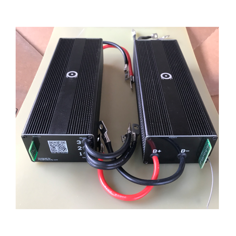

Trampa board has 100V VESC
Also as j bjork say fardriver
Ebikes phaserunner peak @100V
Trampa board coming out with a 100V/40KW+ VESC unit per their website
