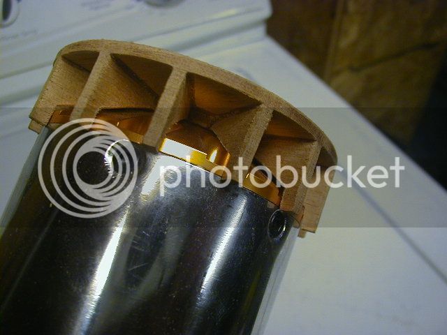

razad7@gmail.com said:
could you show me your "aired" mount?
do you confirm that your stator is partly held INSIDE the motor mount ? (meaning that there is a machined "blind hole" as big as the motor diameter within the thickness of the mount ?)
- sorry I am not native English speaker -
usually the stator is fixed on a flat section of the mount in a way that you still see those "airway" holes... here is a version of mine...
Hey
The engine is indeed inside the mount.
You definitely have a case here.
like i said i will make some holes for air intake, but am worried that the mount will get weak.
Pic:
Ok, thxs for the pic'
it seems quite obvious that the gap between the stator and the motor mount is smaller than the air intake openings, leading potentially to lack of convective cooling...
if you are too scared of drilling holes for the air to flow in axially, you could eventually machine your mount to the thickness which remains at the "motor hole" (air would flow in radially but it should be anyway much better) - great mount by the way
