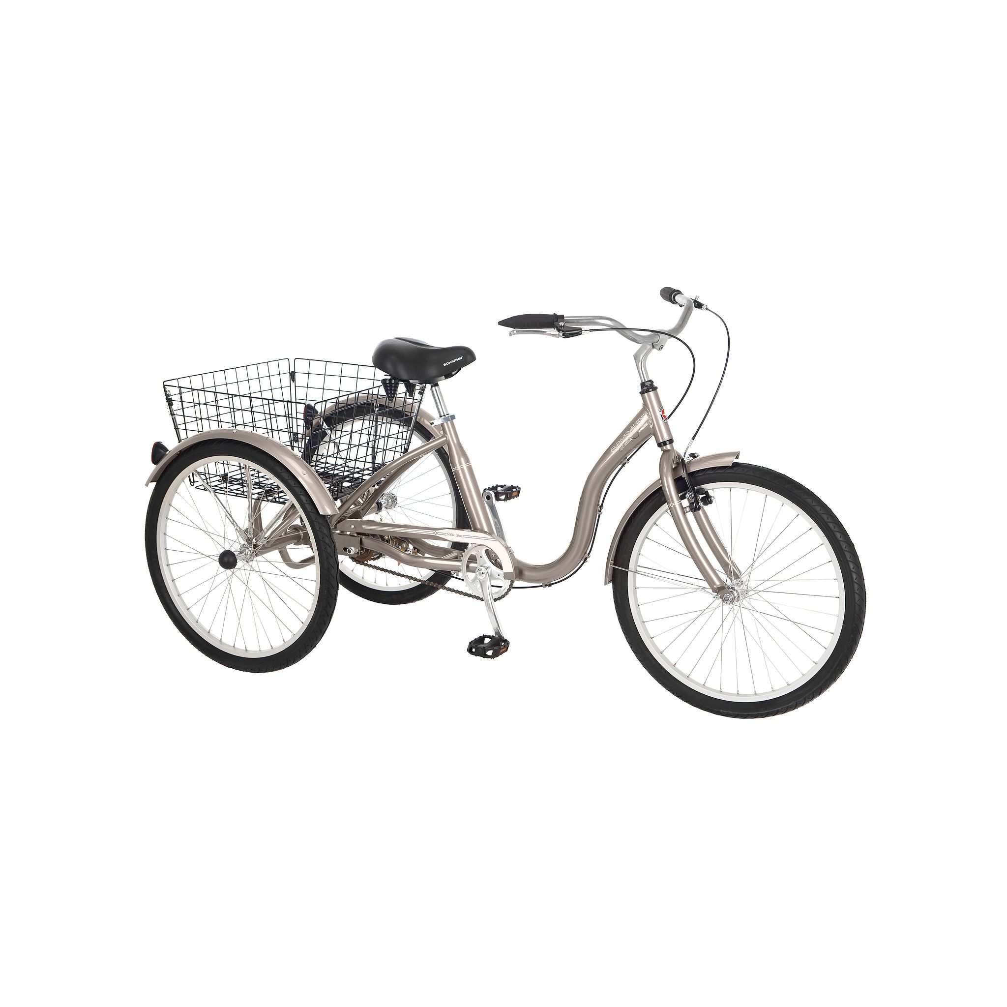

This is my mother's trike Schiwnn Meridian bought it for $200 new. She had balance issues also, had to give up her bicycle.
I added Bafang G311 (front, no traction issues) and grin's 20a Grinfineon controller, CA3, PAS and thumb throttle. Moved the basket back couple inches and mounted 48V (don't remember AH) battery in the frame out of the way. fold the basket down and the battery comes right out. She has been riding it for 1.5 years 10-15 mile rides on the greenway. She peddles but on hills or whatever she uses the throttle. I have max watts set at 700w thought abut lowering it to 650w. I'm sure she can do 30-40 miles on a charge. I don't charge to high or run to low. I road it to the auto parts store last week to exchange a car battery. It has a roomy basket.
Not as stable as my tadpole.
Single speed she does not like the fancy stuff like shifter or switches so it is quite basic.

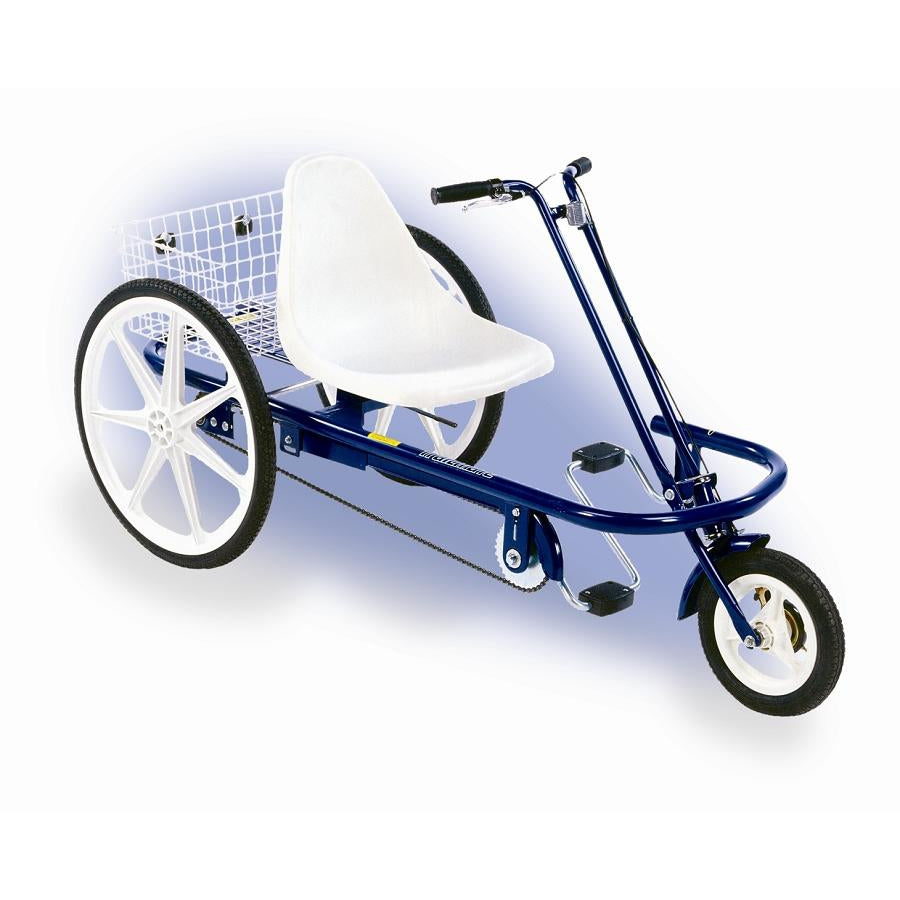

It's a Raptor mobility trike, made for really obese people to get exercise. It actually rode better with two people or the springs were too stiff!
I took the stock seat off and used a scooter seat for tandem riding.
The rear wheels are insane. They're each two steel rims, one welded inside the other, it could easily hold 350 lbs.

median may be the low cost solution but have $1200 in it. there are better trikes, was not sure how much she would ride, it's less every year.
If you mean Schwinn Meridian, those are pretty awful trikes. The most grievous shortcoming is the wheels, which are very weak and damage prone. The hubs are proprietary, so to upgrade to better rear wheels you have to swap the axle for one from a Husky or Sun Baja trike. It gets expensive, but you still have a mostly crappy trike afterwards.
They use those things a lot for non-motorized parades in the Mardi Gras, and they break down a lot there too.
I suppose an old lady is the best prospective user of that model, and I’m glad you seem to have sorted out something satisfactory for her needs. It just disappoints me every time a customer brings in a Schwinn Meridian that needs more than new tires and a chain, or brake work, and there’s nothing cost-effective I can do to fix it.

Well I don't like the factory wheels and try to stay off of it but it's great for her. only put 20 miles on it this year might be a while before it needs a chain.

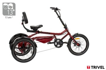

The pinnacle of top-of-the-line trikes are the German built Hase. Start here: https://hasebikes.com/47-1-Canada.html
The Hase Trigo-Up (image below) starts at around $2700. There is also a Trigo model with USS (Under Seat Steering).

I'm not sure that she would be able to easily ride a recumbent with her disabilities. At best, it would be hard for her to get on and off the bike.
I take my my earlier suggestion of using the Meridian, or at least the rolling frame. There are too many crappy parts on the bike, and if the frame is too flexible, then there are NO good parts.
