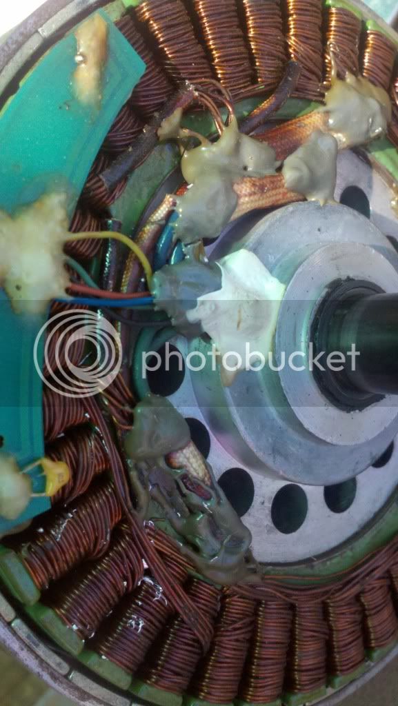

Update:
Finally Toasted the BMC V2-T, although I think it was avoidable.
Looks like some solder melted...
This motor has taken a lot of abuse, and I was beating on it pretty hard up until when it failed. I think it could have lasted many more miles if I didn't start going overboard with the wheelies, especially while going uphill. Overloading it repeatedly at very low RPMs to help pop the front wheel up, while climbing a hill, that's what did it in. I was also testing the limits of hill climbing before it happened as seen in the video below, so heat soak probably contributed. The way I normally used it it never got too hot, and a wheelie here and there didn't seem to hurt. About 20 in a row going uphill apparently does. In trying to find the balance point, I have done many more wheelies than that back to back on flat ground before and it seemed to handle it fine, but perhaps it was slowly building up to this.
I am going to try out the V3 next and see how that holds up to the abuse. Hopefully I will be able to fix this BMC V2-T. After the final wheelie that killed it, the motor would barely, if at all turn, and only once I got it to keep spinning under no load by starting the spin by hand, then I stopped it, throttled again and nothing.

Excellent video ! Might be the camera making it look more deadly but some segments of those trails look like they could hurt if you slipped off the path !! hehe..
I"m surprised the motor lasted as long as it did ! those geared motors are not built for this type of rough stuff..
Ha ha, that fall looks like a lot of my mishaps. Those trails look like a blast to ride. I'll have to post some of my trail rides this year.
The solder mess actually looks promising. The phase wires look in tact and not darkened. I suspect the heat just melted the solder and the hall effects let loose. Try resoldering it back. That has been a fix for many who overheated to where the heat melts the solder joints. Clean up the solder blobs though, you don't want those to create shorts later.
How did the gears look? I plan to abuse mine more this year with jumps. So far mine has been rock solid on 40 volts. If your gears look good after what you have been putting it through, mine should have no issues.

The ride was great, but we did run into some issues with the BMC V2. It makes a strange whirling noise when the throttle is pulled hard, it seems something is loose inside like a spinning gear. The upside is it still works fine, it is just making a weird noise. The V2 deserves some credit though, this hub motor has been through a lot of abuse as you can see in the photos. We will be taking it apart for inspection and get back with more later.

Thanks for the advice! Dave re-soldered the connection and the motor worked fine again. The gears also looked fine upon inspection, no visible indication of wear.
