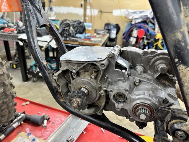

Thought this forum might appreciate my build.
I've got KTM dirtbike that I'm converting to electric, retaining the clutch, transmission, and original crank. I've been through a few iterations in different frames, but the right call here ended up being my 2011 KTM 300 XC. Today I finally had the time and motivation to tear down the dirtbike:
And drop the bottom end into the bike:
I've got the rough mounting locations figured out:
Awhile back, I spent some time on the forums discussing the value of a clutch and flywheel on these bikes, and the transmission is also critical to maximizing acceleration and drive/slide at low speed while also maintaining a reasonable top speed.
Next steps: Split the cases, remove the conrod, weld up the crank so it can't rotate around itself, balance it to minimize vibration, weld a sprocket mount to the rotor (or just lazyweb and weld the sprocket directly), build the motor mounts and battery box. Then find a location for the controller, wire everything up, and it should be ready to go.

Managed to make some good progress after work today!
Split the cases:
This Motion Pro crankcase splitter is very expensive but also a wonderful forever tool.
No conrods allowed:
If you don't want to retrue the crank, just angle grinder the conrod off.
Welded the crank up, as a 2 stroke crank really is not designed to be driven off the rotor side:
And the bottom end back in the frame and ready for me to start on building the motor mount, battery box, and controller mount.

I got the cases sealed up, and the upper motor mount fabbed up:
Following that, I discovered something pretty disappointing - the placement of the electric motor + crank sprocket is such that I'm perfectly between the link sizes on the chain.
Need a half link in 428, because I welded on the lower sprocket, the upper sprockets for my particular QS138 configuration only seem to be available in 520. Don't have enough space to significantly move the motor, or have enough space to fill the slack of a longer chain with a tensioner assembly. Half links that don't use a cotter pin assembly seem to be pretty exclusively available from overseas dealers. So it goes!
I'll probably get impatient and just fit the QS120 I have instead. I designed everything to be pretty modular, so it's just 3 parts (upper and left / right side brackets) to swap motors. That'll drop me to about 50% of the power I had intended, but it will be a bit more power than my electric motion trials bike with the option for much shorter gearing, so maybe it'll all work out.
