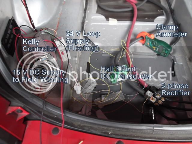

Did some work today worthy of a minor update. First of all, the current-controlled charging system works, but needs to be tweaked to make sure it's set to the right maximum excitation voltage. I'll do that part tomorrow. For now, here's the test hookup in the trunk:
That's essentially the same setup as in the schematic I posted a few weeks ago, except that I went to the DC side with a hall effect transducer. The upside is that it's receiving a much less noisy signal than the AC side of the rectifier would have provided, but the downside is that it required the 24 V supply to run it. I use the 0-5 V signal that it provides, which floats relative to the motor controller's supply, to "throttle" the motor controller's current supply to the exciter winding on the generator head. I tested it, and the charging current now never exceeds 30 A DC. I have to program the controller for its maximum supply voltage to make sure that maximum excitation is exactly right. Again, that's a job for tomorrow.

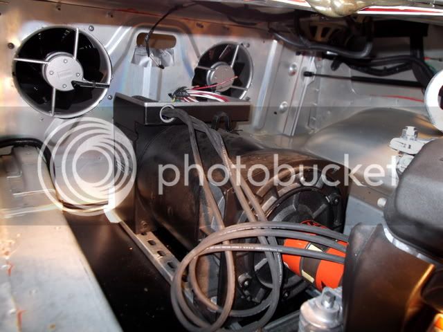

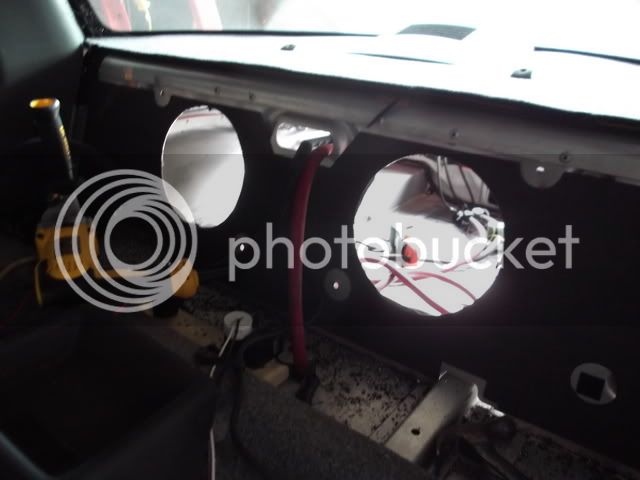

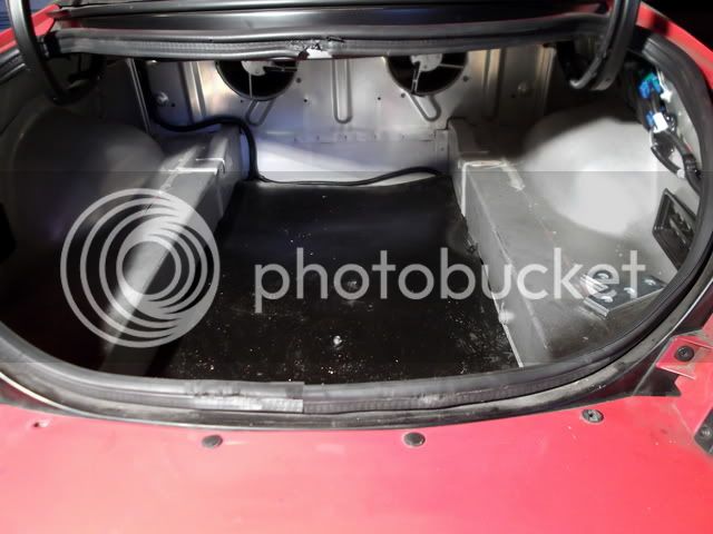

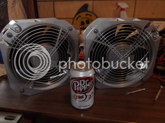

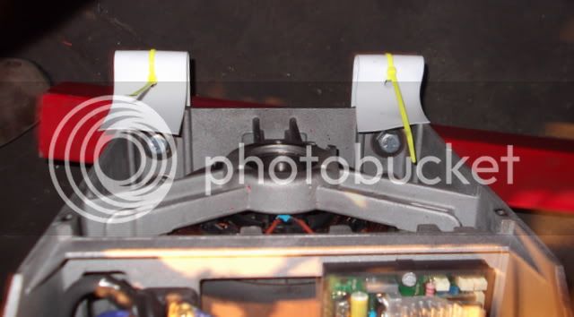

The main job of the day was to get cooling set up for the trunk. Both the gen head and the engine are air cooled, and that little space will get hot unless it's actively ventilated. I'm not sure if I ever posted a photo of the area behind the seats, so here's one with some labels:

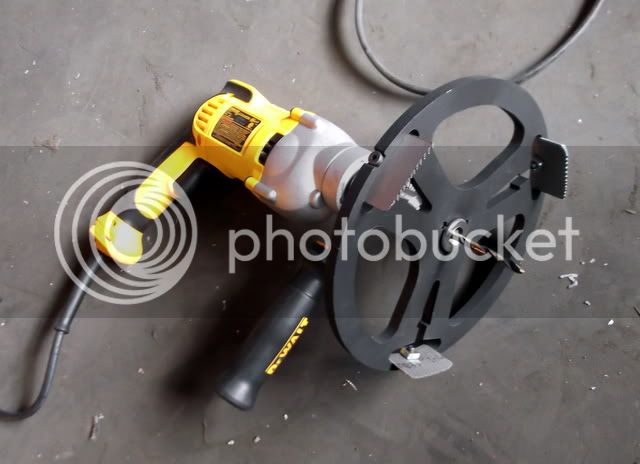

The idea is to use these two 600 scfm fans. I estimate that they'll turn over the trunk air volume twice every three seconds or so with cool air from the cabin, which should work well. They only pull about 80 W each.
The problem is that the blades are about 8.5 inches in diameter, so I had to use a large hole saw with an arbor. The drill needed to be one with a half inch chuck, so I got this beast. Today, it had the last laugh.
Here are the pilot holes and the finished holes.

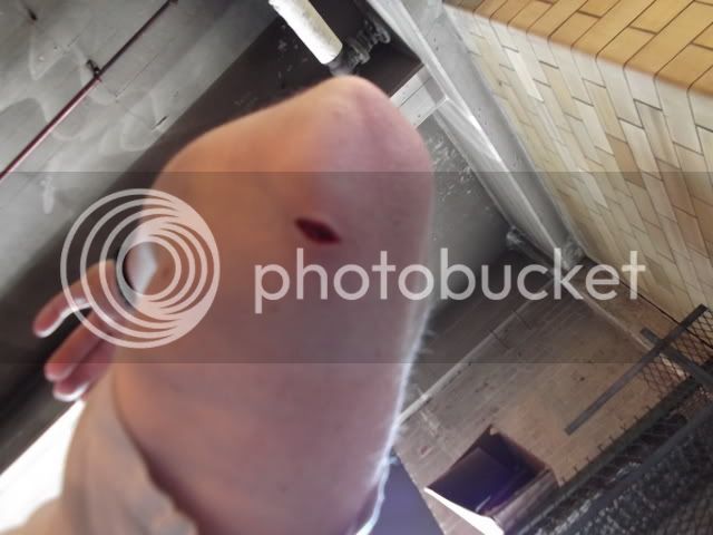

I didn't realize it when I took that last picture, but I had been injured. While cutting the last hole, the blades got gummed up in the sheet metal and the drill jerked/kicked back at me when it was going near full speed. My arms got jerked clockwise really quickly, and my left elbow hammered down on the ridge just below the holes, which was carpeted. I thought I just nailed my funny bone and waited to get feeling back in my left little and ring fingers before finishing the hole. When I put the camera down, I felt something wet on my side. Showed up well on a white t-shirt.
Turns out the carpeting tore open a hole just above my elbow. Tough picture to take, but here it is.
Looked like it needed stitches, so I went to the Emergency Room at Howard University Hospital. For those reading from outside of the United States, Emergency Rooms are where Americans like to go to wait around for several hours while bleeding to death. After about 3 hours of waiting I got some of that new glue-type sealing on the wound and a tetanus shot (which took all of five minutes) and I went back to finish the job. Here's a video of the fans firing up once the inverter is turned on. They really move the air through.

Hey Jason,
You should have put those fans on the back side of the boot(trunk). Then instead of sucking the back seat passengers into the trunk you would have had electric jet-assist! :D
paultrafalgar said:
Hey Jason,
Now you're talking, Paul. I was thinking with the fans, LEDs on the dashboard, etc. that I might as well finish what Doc Brown started... let me know if you have an extra Mr. Fusion!
TylerDurden said:
Those fans are a hoot. :D I would suggest radials tho, good flow, less noise.
Hey TD, good to hear from you. I had considered radials, but couldn't get the flow rate I needed in a small package. As long as you can keep the pressure drop relatively low, axial fans are the way to go for high flow rates, although they are a bit more noisy.
Weird thing is, and maybe this is common, but the fans sound a lot noisier (more of a hum) on the video than they did in person. I think that the camera mic is more sensitive than the human eardrum for those frequencies...
Cleared out the wiring, etc. from the trunk (boot!) and have put down a rubber liner on its floor. Chris and I will try to cram the genset inside tonight using the hoist and a bit of elbow grease.

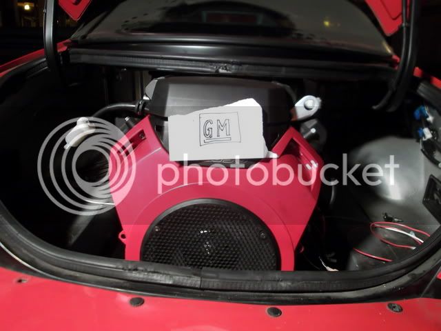

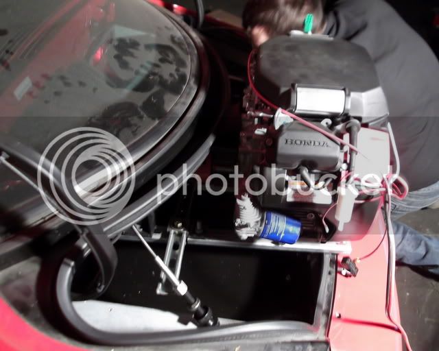

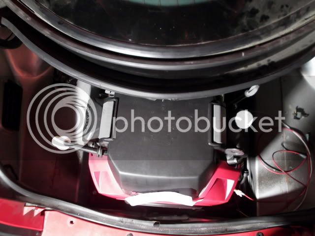

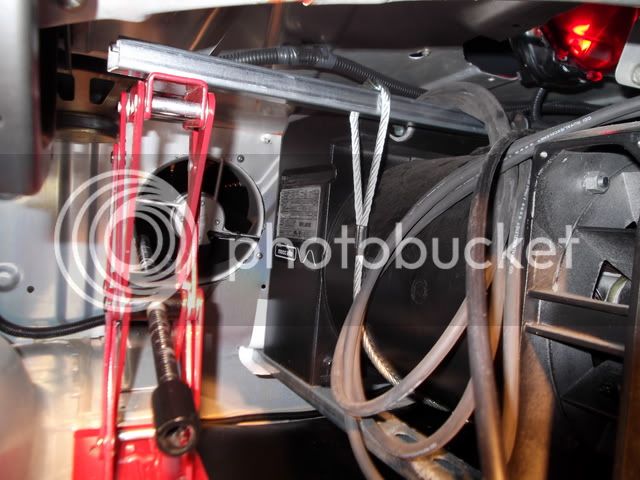

Last week Chris and I tried to cram the genset skid into the trunk and basically hit a brick wall progress-wise. Tonight, after planning over last weekend, we had much better luck.
The first step, which I actually did last week, was to put down a relatively thin (3/16" thickness) polyurethane sheet that was cut to size on the trunk floor. This was to help dampen vibration and to give the genset something squishy and grippy to sink into.
The generator head goes in first, with the engine to be positioned at the rear of the car for easy access. That's tough, because the generator head is way heavier than the engine. In fact, to move the skid around, one of us would work the hoist to raise the gen head while the other hefted the engine by hand to keep things in balance. It was a good workout.
I covered the skid end on the generator side with Teflon "footies" to help the unit slide forward.
The problem in inserting the set into the trunk came when the throttle body was blocking any effort to push the set further in, so that the engine could drop down. Note, this is after the muffler was removed to give more room to slide forward.
This was where we hit a dead end last week. What needed to occur was raising the generator head (already deep in the trunk) nearly up to the roof of the trunk, so that the engine could drop forward and down. The problem was that the head weighs 80 kg and there was no way to get to it.
So, we used a wire rope around the generator head body, put a steel channel strut through the loops, and used to scissor jacks to lift it basket-style all the way up.
We brought it up to the ceiling, and scooted the jacks forward (while loaded) to drop the engine in. We had to take the face plate off the fan, but it went in.
Keep in mind, this was a tight fit. It was worse than a square peg-round hole, childbirth, or trying to get that big couch into your apartment when your front door is on a tight staircase. Here's a view from the top.
How did we do that?! And there was no room to fool around with. Here's an idea of how close the gen head is to the cabin wall. Things did fit nicely in the end, though. The fans are not obstructed.
I didn't even plan on this part working.
[youtube]55-eqVZA1S0[/youtube]
Granted, we had to take out the trunk latch to get the engine in, and it has to stay cracked (for now) to keep the air flowing, but closing it up was a nice touch. Also, although it's not clear from the photos, the muffler is back in place. I'll tie the exhaust line in when I get a chance.

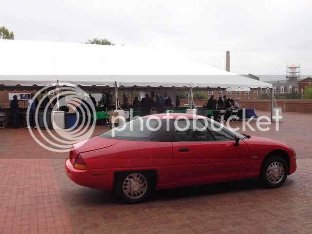

Greg, your post reminded me that I forgot to post on Friday night about the stuff going on around the University with the EV1. Early last week, someone from our Operations and Maintenance Department stopped by the garage while I was finishing up wiring the current controller and other electronics in the trunk, and they said that some of the administration wanted to see the car on display for our big 2011 Earth Day celebration. This made me nervous, but I was convinced that it wouldn't be a bad idea to show off the car now that it's pretty much done. Here are some pictures from the day.
One perk was a free car wash. This guy was from Landscaping, and volunteered to help wash as long as I let him ride with me.
The Redskins fan didn't like the way the other guy was washing and nabbed the sponge from him. This caused a hilarious argument. I wish I had video.
Every show car needs a model.
We had a University SUV cover my six to hide the fact that we had no plates, and I drove it about a quarter mile through the streets and up some steep hills to get to the pavilion behind the undergraduate library near the main quad. The generator gave me the juice I needed.

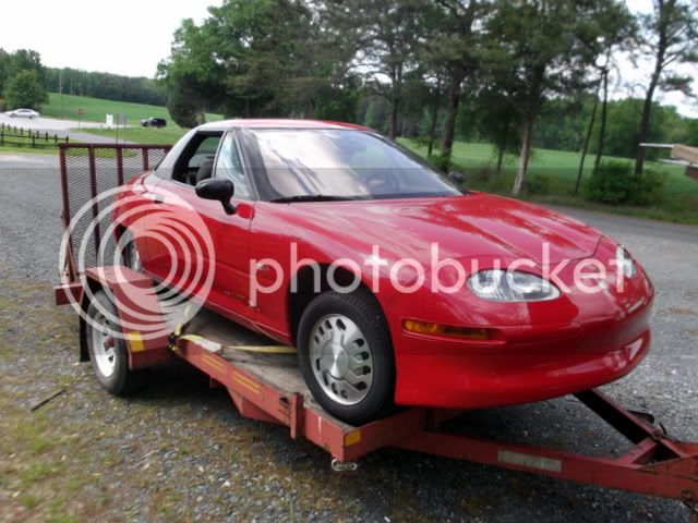

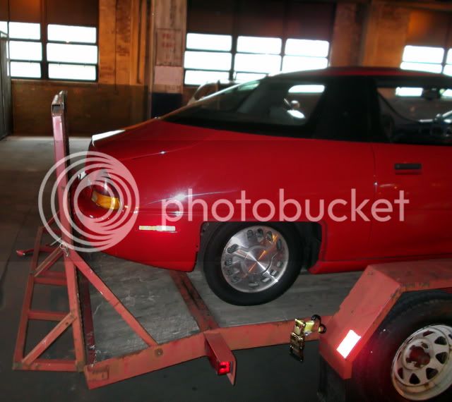

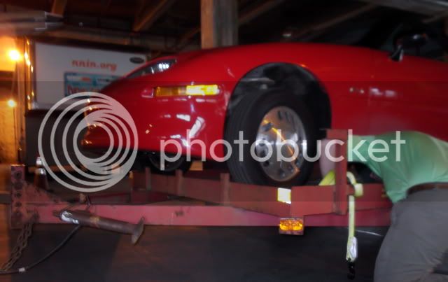

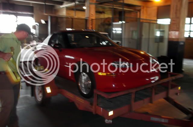

An important day comes to an end. The last thing I needed was to get some open-road speed tests for the car (basically, motor phase current or DC power draw vs. steady speed) to get parameters for the overall propulsion model. This afternoon, Chris and I loaded up a trailer that he borrowed and headed out of the District and into the wilderness of Maryland.
The trailer, unfortunately, had a front railing that kept us from raising the tail ramps all the way...
... so we hacksawed that off and things fit like a glove.
Perfect parking spot when we grabbed a bite to eat on the way out of town:
We reached the undisclosed location in about an hour. This car sure does look nice on a sunny day.
We spent the next hour or so taking data on a flat stretch of road with minimal traffic. It was a little monotonous but still fun to be out in the open. On the last run back to the trailer, we switched off the charging circuit (engine still running) and Chris floored it to see what kind of speed he could get on caps-only power. Listen and you'll hear the tires squeal.
