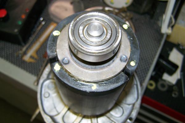

I have this working 1 hp blower motor and was wondering if it could be adapted for an electric bicycle use. Anyone attempt this?
Or is it one of those...well you could, but it wouldn't be worth it. :wink:

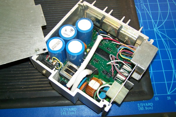

Thoughts are an external controller. But would like to install hall sensors. Perhaps above my pay grade. Sensor less then? Gear reduction.
Have to check and see what DC voltage it's firing on now.
Here are the particulars...
GE ECM 5SME39SG 1 HP 0-1300 rpm 115 volt 60 htz 12 amp motor
AKG03 0904 existing controller... no, don't plan on using.

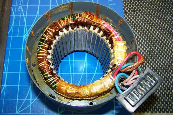

I count 36 coils, 3 phase wires, and 6 magnet poles but no guarantees. (2 of the motor wire connectors are for a temperature cut-out)

I don't think you'll like the weight to power output ratio of AC induction motors. Especially for an E-bike project.
I mean are those even magnets on the rotor? It looks like 3 Iron slabs in the shape of magnets lol
Also, from what I know magnets on a brushless motor have to be divisible by 2
Don't be led astray by the motor specs... It's original controller rectifies the A/C to D/C and controls it with PWM. I'm thinking 1 HP is 1 HP, weight of no concern.
They do seem very unique. What seems stranger is that each one has two positive poles. If you look close at the picture, each yellow dot on the magnet end represents a positive pole that I had marked out.
See above...

Yes they are magnets but not horribly strong
I looked back at my rotor bar/ stator slot diagram and yes these small motors often operated with odd number rotor bars to stator slots, perhaps this also works for magnetic rotors?

I'm interested in your motor windings having 2 sets of 3 wires... have you determined how it's wired? One set a spare?

The magnets seem very unusual. :shock:
I too was surprised to find 3 magnets, guessing it was due to its design being a low rpm/high torque...
If the admin wishes to combine these threads or can great idea
I too don't have a specific use for this motor but who knows it might wind up on a kids go cart...this motor has a single winding, Y wound 3 phase stator
