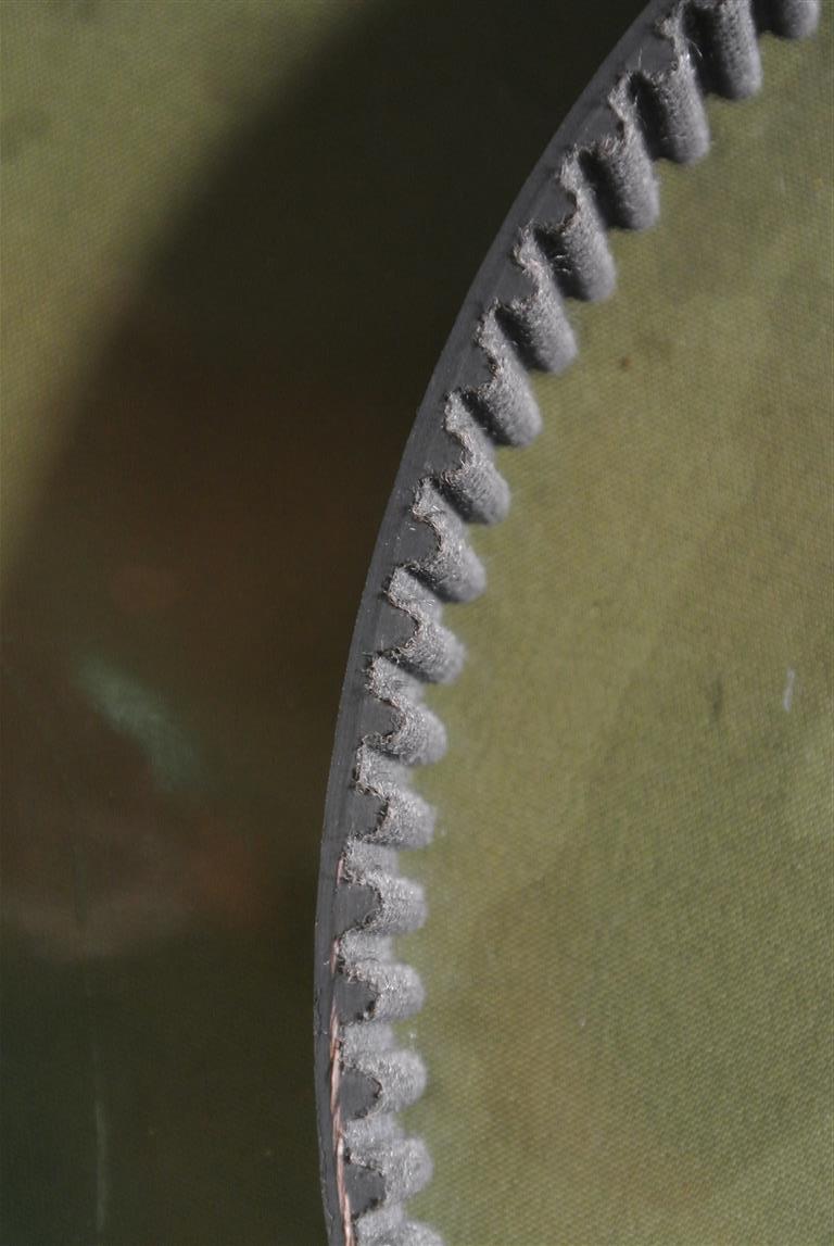

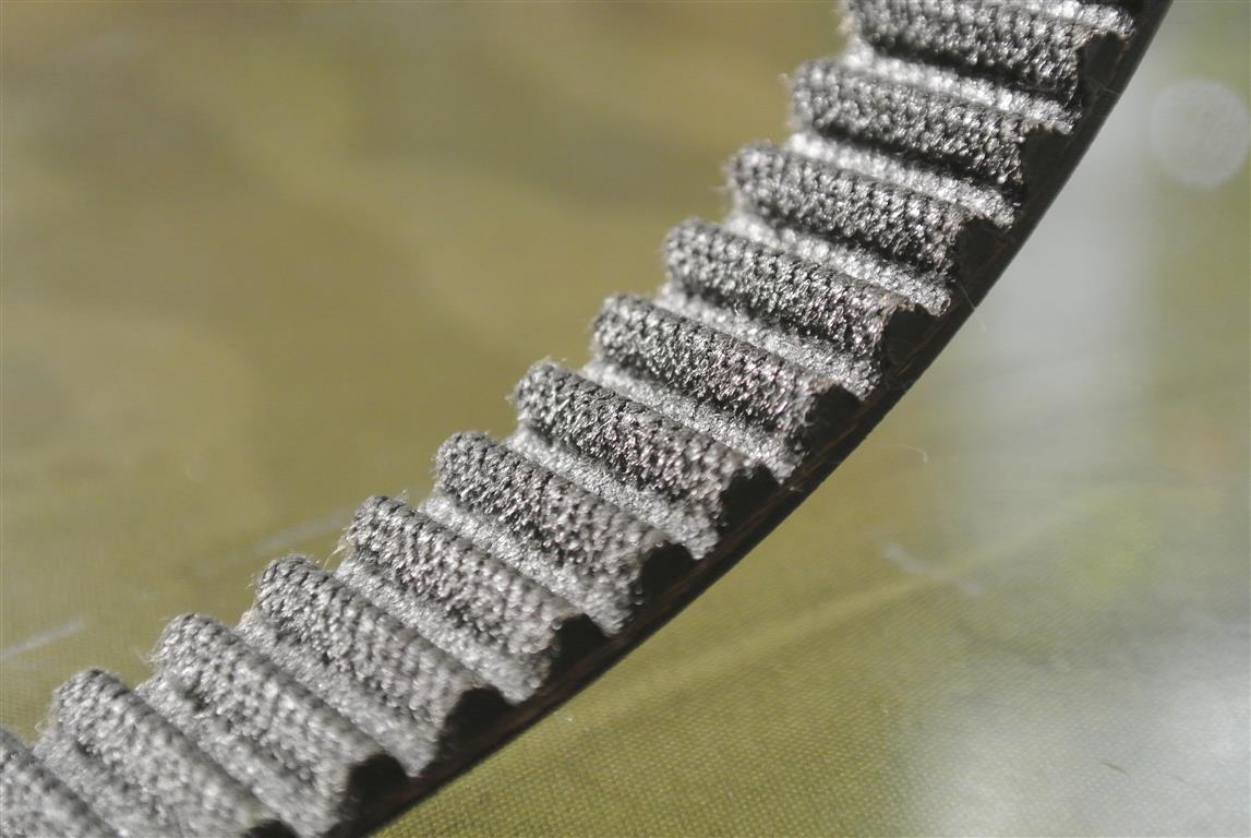

The newest GNG kit has upgraded to a 20mm wide primary belt (stock was 15mm wide), so they are trying. I assume they are feeling the heat of competition?
The #25 chain primary mod (linked in the first post of this thread) seems to work well if your user-profile is hard on the belts. That being said, I am told the belt is quieter than the chain, and replacing the worn belt every few hundred km is not horribly expensive, so...you must decide between reraltively trouble-free, cheap and noisy, or...slightly quieter along with the cost a new belt once in a while.
