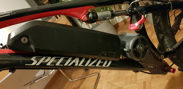

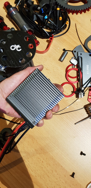

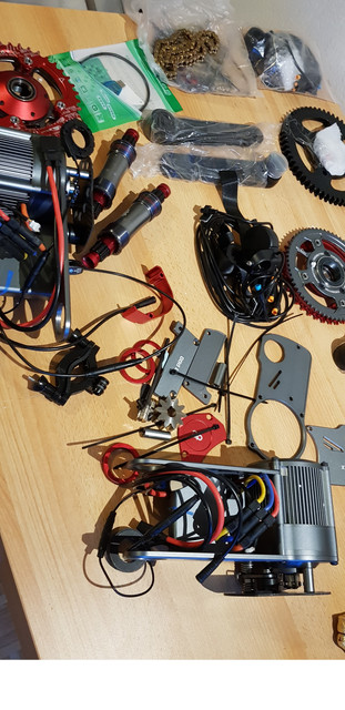

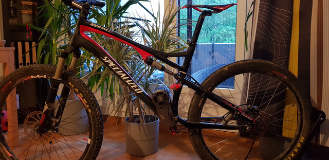

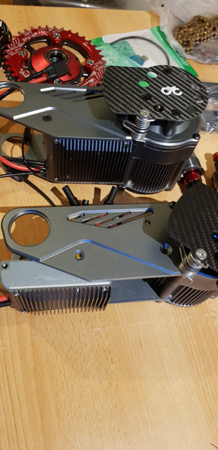

Hey guys, just got my motors, ordered 2 chain kits and some more parts to try different combinations.
will build one bike with the motor in the frame, so i have to separate the controller from the sheets and mount it elsewhere, probably under the downtube, near the BB.
controller looks nice and is pretty small, its the 48-52Volt version.
motor fits nice in this Specialized Epic Elite-frame, i tought that it would have some kind of flex, but it feels rock solid for now
there would be enough space in the frame to mount a EM3-Supershark, but i try to keep the bike as light as possible, so i think i will go for the backpack-style again... but not sure, since it would be a such a nice fit.
we will use the new HG2-Cells from Em3ev for both bikes. Im very happy with the 14S4p and 14S5p-packs with those cells. not sure about the specs, but feels more powerfull than the Samsung 30Q and 25R-packs (?).
Think i will limti the power to something a bit over 2kw, as the bike is not the strongest (ca. 12Kg)
