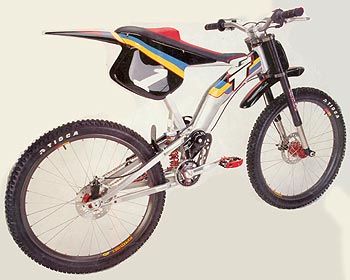

WOW, that's one cool frame, it does look like an exact copy of BMW design, accept I bet the GT is Aluminum. Any confirmation on this? You could also make some cool torque arms using that rear dropout slot. So the 8 speed goes into the frame as the jackshaft? You guys might run into some issues with that left side drive on the hub motor. Can't beat the price though...
Apperently it's based on this bike from 1997:
i'm with you. but the drive train concerns me, esp if ratios no good for high speed, not to mention the expense...

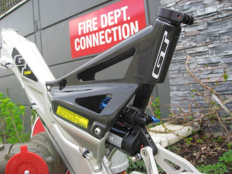

i've been looking at this one. and some closeups of the seatmast from here:
i'm thinking i could replace that seat mast w/ another that has a container for lots of lipo, (and clamps up near the headtube too) and a more motoX seat more like the one from 97..
damn, It looks sweet too and It seems lacking placement for the LiPo battery pack seats unless you are going make a
fiberglass molded case on top of the frame.
