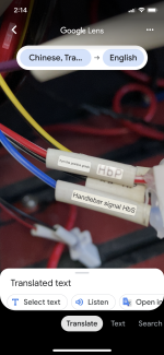

Just trying to decipher & translate some of the current connectors between my controller & bike wiring.
I used google translate but can anyone shed some light on the following connectors?
What could the handlebar signal wire be?
Google translate says both sets of BRK wire are High Brake. The single wire BRK is connected but the 2-wire BRK is not connected. As far as I can tell regenerative braking isn't active b/c when I let go of the throttle with the rear end on a stand, the tire takes a while to stop spinning.

Handlebar signal could possibly be several things, but not sure what. Does this controller have a display? That would be my first guess.

You could turn the controller on and measure the voltage on the Hbs wire. If it measures 5v, you could try grounding it and see what happens. This may be for a handlebar mounted kill switch.
Thank you fechter for your help & sorry for wasting everyone's time who read this. This was one of my dumb moments, turns out the handlebar signal connector is actually the throttle control. I thought I had already labeled it in the spring. I guess this controller also uses the high brake connector as indicated right on the controller label.🤦‍♂️
OK, glad you sorted it out. I've been fooled by the factory labels enough times myself. Many of them don't even have labels.
