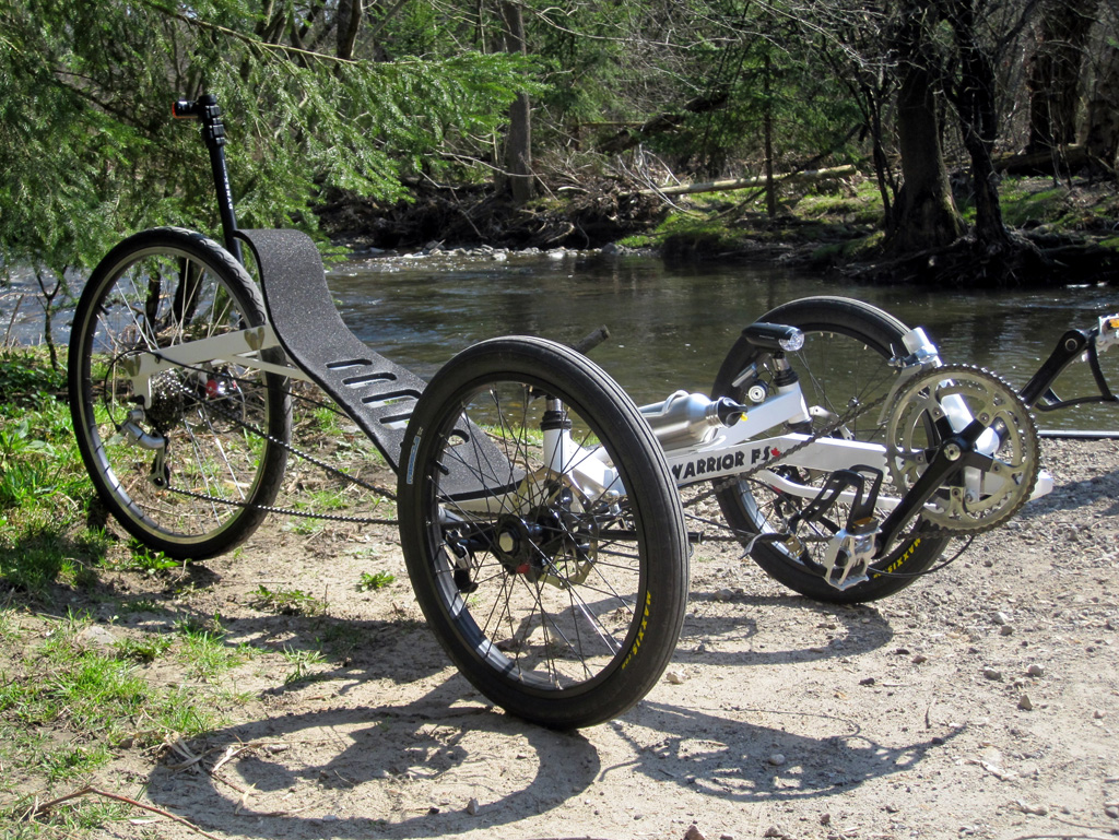

We also need to know the approximate weight of you and the bike. It would also help to know what trike you plan to mount this on. "Warrior" is a pretty generic name.
farmerjoe99 said:
total weight including rider and E-parts should be under 270lbs.
Joseph
I'm 5'8 152lbs and Its looking like the trike with electrics will be right around 100lbs
Sorry thought the atomiczombie warrior was a little better known, here's a few pictures of them:
It's looking like the battery will be mounted behind/below the seat on the drop tube.
Joseph
