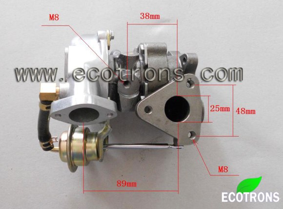

I suspect a NOS kit would be more effective !
and this small turbo kit is under $300 !
I think a brushless motor hooked to the compressor of the turbo would work well. But if you go to the effort of driving a supercharger with an electric motor WHY NOT JUST DRIVE THE REAR WHEEL WITH ELECTRICITY????

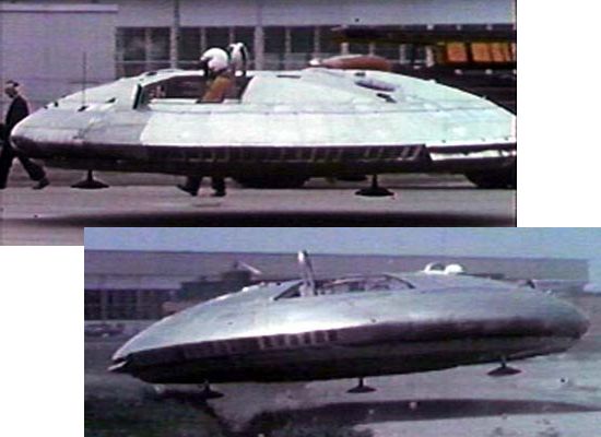

Hey, let's not forget the AvroCar. Thanks to looking for a pic for this I learned that they did have a few modestly successful flights, I thought it had always been too bouncy and twitchy. They learned so much from the ducting and channeling that has gone into the F35, but they got tired of the project and cancelled it in 1961 when apparently they were on the verge of a breakthrough. Unrealized at the time, of course.
I love the one pic where the guys feet seem to be sticking out the bottom.
