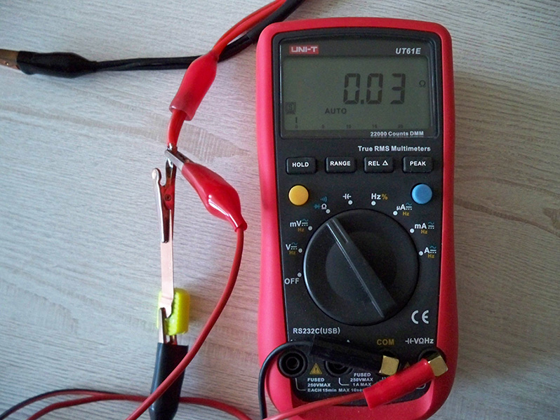

the problem is not the holder itself, the problem is that this battery tester measures the voltage over an alligator clip some cm away from the cell where up to 20A going through.
The same thing you can see on lygte's holder where each terminal is placed in 1cm from the battery and they are not made of copper, if you look at their color. I'm tired of repeating the same thing over and over and over again... Please read previous comments.
madin88 said:
If you talking about Ah, yes you have right they don't change much, but as the tester measures about 5-10% lower voltage at 15-20A, the watt hours will be by same percentage off.
The tester measures the voltage which the cell has so there is no "5-10% lower" problem. Just write somewhere with big letters that all the cells are not same and that voltage drop from my holder to the measuring point is so low that i can ignore it (thanks to pure copper). Once again, read my previous comments to not make me repeat, please.
P.S.
My UNI-T UT61E's reading with shorted probes:
And the resistance between the battery contact area and measuring point:

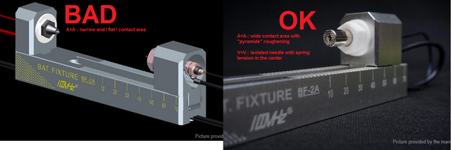

For this particular problem I add some theory:
1) The 4-wire principle of cell connection to the tester is crucial and so the design of cell holder/fixture is also crucial. Especially for reliable repeatability of measurement. The most important is complete isolation of the voltage sensing from the chg/dchg current flow. The most reliable way to achieve this for small cylindrical cells is the fixture contact terminal with the inner insulated needle for voltage sensing.
2) If you have isolated voltage sensing, directly connected to the cell surface, you do not have much to worry about the contact or wire resistance within the current path. It actually does not matter for the current measurement where the power is disipated. The only problem with higher terminal contact resistance is the local heat production on the cell surface.
Here you can see the idea of an "optimal" design of small cylindrical cell connection. The roughened surface combined with smaller pressure is always more reliable than flat connection under high pressure. Similar design is commonly used by professional companies like Arbin or Novonix.
The manufacturing quality of the cell fixture is also crucial. Any misalignment of the cell in the fixture can cause significant measurement error. There are available few types of cell fixtures using this design but most of them suffers from poor manufacturing quality which leads to the problem with cell alignment within the fixture. This BF-2A fixture available on Fasttech or Aliexpress is one with the satisfactory manufacturing quality.
My thought for this case is that both thunderheart and Lygte cell holder designs are similar and both are missing the isolated voltage sense which is not optimal and each small misalignment of the cell in the fixture easily may cause significant voltage drop. I have seen this behaviour many times ago when I was experimenting with similar design cell fixtures.
The second discussed problem is the similarity of Samsung 30T 10A and 15A discharging curves which is definitely an error. We can only talk about how it was made. Such mistakes happen quite often and personally it has happened to me a few times too. I think it could be made in the EBC software, where you maybe did not confirm the change from 10A to 15A and then run the measure still with previous 10A setting, but you save it as 15A curve. If you have stored a measure data in the .csv or .dat files for both curves, please post it here, as they can easily explain this issue.
