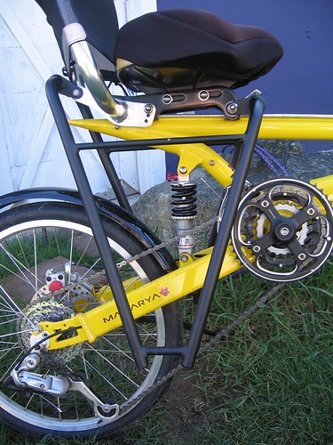

Did you know that cannondale made some custom racks for their recumbents ?
A42Hqu
If one manages to actually find this thing, it could help you out with your dual battery setup.
Here I'm not so convince anymore. After the first excitement, it turns out with a recumbent I'd really miss the one thing I love the most when cycling: standing on the pedals and being able to actually see over all the cars...
Oh wow, even though that's a maxarya bike ( and probably a rack to fit ), that looks to be a fairly solid idea for mounting.
My seat rails are not so easy peasy but i might be able to come up with something, so thanks for the idea.

On flickr, the picture's legend reads:
"Cannondale designed this underseat pannier rack for their Bent I & II (formerly "Easy Rider") recumbents. Maxarya doesn't currently (as of March 2006) sell an underseat rack for their bikes. It's a miracle the Cannondale rack fits with no modification. I used underseat racks on my BikeEs, and recommend them as the best way to carry gear on a recumbent."
If this is correct,it means easyrider, bent I and bent II seats are interchangeable with maxarya's, just like the rack. This guys has the racks mounted on a bent I: https://www.youtube.com/watch?v=b9S6CXS5fPk

I found some other pictures of the rack, but could not find one for sale anywhere. Though this is not exactly a shocker.
Found a for sale ad that had a pretty good picture of the rack. The bike is of course already sold. but it clearly shows where the rack's weight sits. Which is a good hint.
I may be able to custom cut some aluminum plates, or hack up some used bicycle racks to mount a shark pack on each side. Thanks again for the killer idea. In the last 2 days, i've increased my ability to walk with a cane a lot, so i'm gonna hop down to the garage and experiment with some 'cardboard aided design'.
Okay, looking over how that rack is made, it's clear to me that it would not be too great for carrying 2x 9lbs batteries.
I cannot just make an easy flat plate because the rear of the bike protrudes into that space :/
It is also not the best idea to hang 100% of that weight off those tiny quick release bolts, even though some tension holds the plate to the frame..
I'm thinking of just building a box in the back.. or some kind of rear pannier thing. It seems like the most sane option for mounting batteries.
