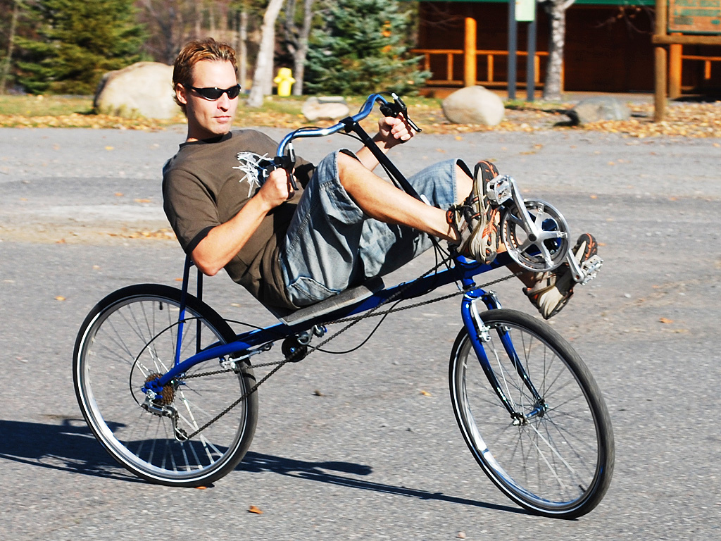

The Atomic Zombie folks got me excited about building something along these lines:
I've decided that if i find that the cannondale is not up to the task of high speed, i'm going to build the above as a practice bike, and then design + build the next generation cannondale bent.
