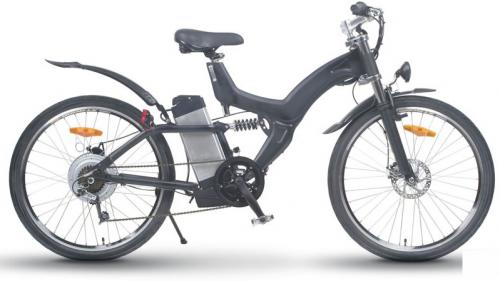

DrkAngel said:
... Getting ready!
thundercamel said:
Where can I buy that bike? :)
Liberty Stealth Climber (MTB) circa 2006 ... eBay, Craigs List?
36V SLA
250w hub motor
Heavy steel frame
2006 video of same model eBike - was only $625! (15 years ago)
[youtube]G61O1VnnFoY[/youtube]
Desperately needs upgrading! As a street-road machine, towards 40mph in 1500w mode.
New version - http://iloveebikes.com/36v-bikes/36v-stealth-mountain-2.html
Gas, elect, whatever; a bicycle is NOT a motorcycle...Speed is dangerous...as most admit....
Figure 25 MPH or KPH is decent urban speed and still too fast to miss errant car door opening. Others use roads also...FWIW...me? Just happy thing worked as planned...finally.
