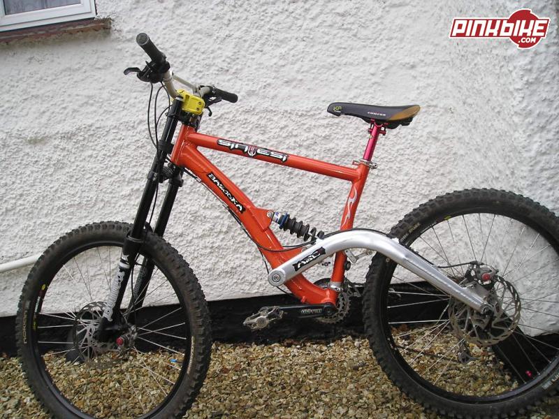

I've been hunting around for a cracked/bent/damaged full suspension frame I could cut up and customise for my next build and fellow Aussie ES member full throttle has come up with the goods. He very generously gave me his old sintesi bazooka frame + a stem and a few other bits and pieces. Thanks HEAPS mate :D
I was originally planning to cut out the top bar and replace it with a 105x50mm rectangular aluminium section to house the 18S2P lipo pack but I'm not sure I want to risk butchering the frame just yet. Full throttle was telling me this frame was $5000 back in the day :shock: I might make up a neat battery box instead, and see how I go for now. It has a small crack in the swing arm on one side but I think this will be easily repaired and I won't be riding it as hard as full throttle did (look at this current avatar for a pic of how he rode this bike :p )
This is not his actual bike, but it's the same frame
This will be fitted up with the guts of the parts I currently have on my commuter bike a few posts up - marzocchi bomber forks, 9" hydros up front and 9C 9x7 24" rear
I'll also be using this frame to copy the geometry for my next big project - a totally custom frame dual suspension mountain bike that will house the lipo pack inside the frame. I'll be using cromo sheet metal with as many bends as possible to minimise the amount of welding. It'll be kind of like the stealth frames but my goal is to keep the frame looking as much like a mtb as possible. So like the fighter, but with anorexia. And leprosy :lol:
