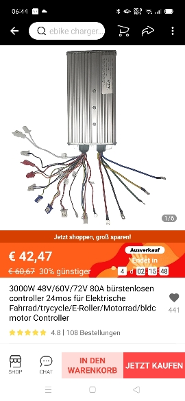

I have ordered an similar 3Phase Controller. Can you share your experience with this controller
Greetings Bob
