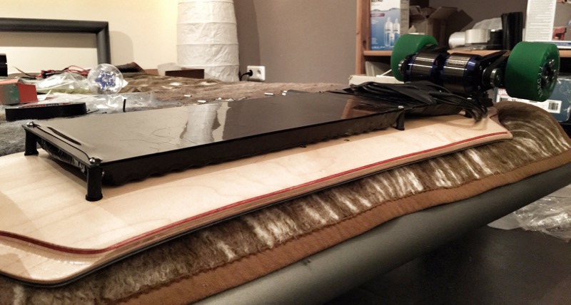

Nice and clean - besides rain/puddles i think it's about perfect. LIke that it gives you some clamping force. Paired with velcro and some quick release hardware so it's a secondary method for securing the batteries? The quick release (1/4 turn fasteners maybe?) would make it easy to pop off and swap batteries. Likely not what you will use it for since you have the mondo 18650's cell you built, but for the rest of us it's a neat option!
Nice work wp!
confirmation on the 275mm belt. for anyone who is running torqueboard V1 36T with enertion 15T, the 275mm belts are spot on. in shortest motor mount configuration, the belt is just slightly loose, a 270mm belt most likely would not fit!

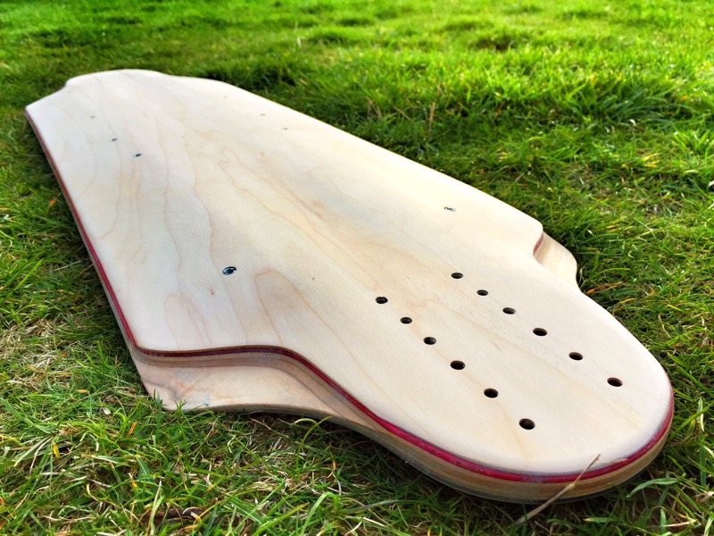

refined the "enclosure" - the aluminum cylinders were too stiff. on the one hand, the topspeed CAN flex afterall, so I felt like it wouldnt work out for very long. on the other hand, all vibrations were transmitted into the GFK plate and the it resonated fairly well. instead Im using these things now to offset the GFK plate by the required 2cm:
while waiting for my order to arrive, I got rid of 2 things: the landyachtz original griptape and the topspeed original graphics which I didnt like very much. went for a "natural" finish, I just love wood really.
been sanding a little and started oiling the roadside of the board. dont have a picture yet of the oiled board, but I oiled some guitars and it gives such a smooth 3dimensionality to wood - love it!
oh yea, you can also see the inserted threads in the wood - they are 8mm deep, outer diameter M8, inner diameter M4. there are a few more now to dampen GFK plate vibrations and hold things into place. :)

gave it one more round of oil after sanding with 1000grit, but it looks gorgeous already. love the mesmerising look and also touch of well sanded oiled wood <3
its probably really a waste of time, knowing how my boards look like after some use. on the other hand I never crashed my evolve yet cause Im not really trying fancy stuff on these expensive boards. so just mayyybe it will actually last a while :)

my new built battery dimension is 10S4P = 40cells in 2 rows, so pretty much 36x13x1.8cm raw, packed up in heat shrink tube its 37x13.5x2cm! think its a great compromise - 12-13Ah with street wheels is easily 40-50km and I know from experience that I wont last longer really. :)

must say, it looks really pretty sleek, just the absolute minimum enclosure, I actually like the idea of the heat shrink tube too - its quite waterproof, fixates the battery nicely on the fiber plate and everything is super dampened by the 6 rubber cylinders that connect the fiber plate to the board. think Ill just keep it like that for a while. didnt shorten the cables yet since I have yet to return the ESCs, so I just loosely taped them to the enclosure.
dont even know where to start to be honest, it was a really really great experience. first of all I just LOVED the landyachtz topspeed, I felt super comfortable with the locked in feet, new griptape is really great too, the riptide krank 87A on the caliber2 work supersmooth, same with the giant abec wheels with the huge shockpads - its REALLY a great feel on that ride. smooth, quite turny, nice grip, much better than the kegels I was using on the evolve.
the board has nearly no drag - was a 3-4% downhill slope and the board was accelerating on its own. turned on nunchuck while rolling, it coupled right away and I started from 10kph - torque blended in fairly smooth until top speed which was something like 20kph. :? I really need to configure the escs in some way to actually get to 50kph I guess? first impression was: very smooth, quite silent actually, no weird noise from the enclosure or components (had put a felt sheet on the fiber plate to avoid any rattling of electronics - that seemed to be working nicely.
was riding 2-3km, just carving through the dark and enjoying the great turny calibers, then I carefully tried the brake on the nunchuck and it basically threw me off :D felt like I was running into a wall. I certainly need to configure the ESCs a little. at the same time I was getting really exited, cause the torque that made the board stop with pretty much sliding tires will be there for acceleration too if I just send in the raw signal. those 2 outrunners are a monster :shock:
